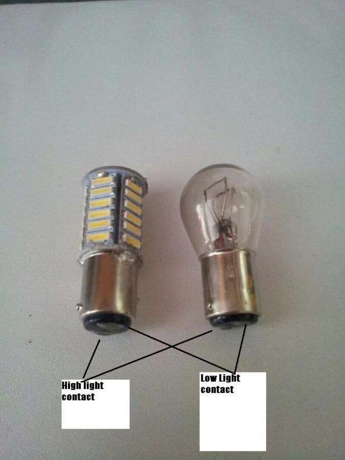

Sorry, I forgot to mention how to tell the difference.
An incandescent bulb will have a short, tightly coiled wire inside the bulb. This is heated by the electrical current which causes it to glow.
An LED bulb can have many configurations. One type will have a small flat panel, a 2-3 mm square, that will glow. Some will consist of what look like several mini-bulbs. Inside of these will be little panels, less than 1mm by 1mm, that glow.
The LED is on the left. The incandescent is on the right.
