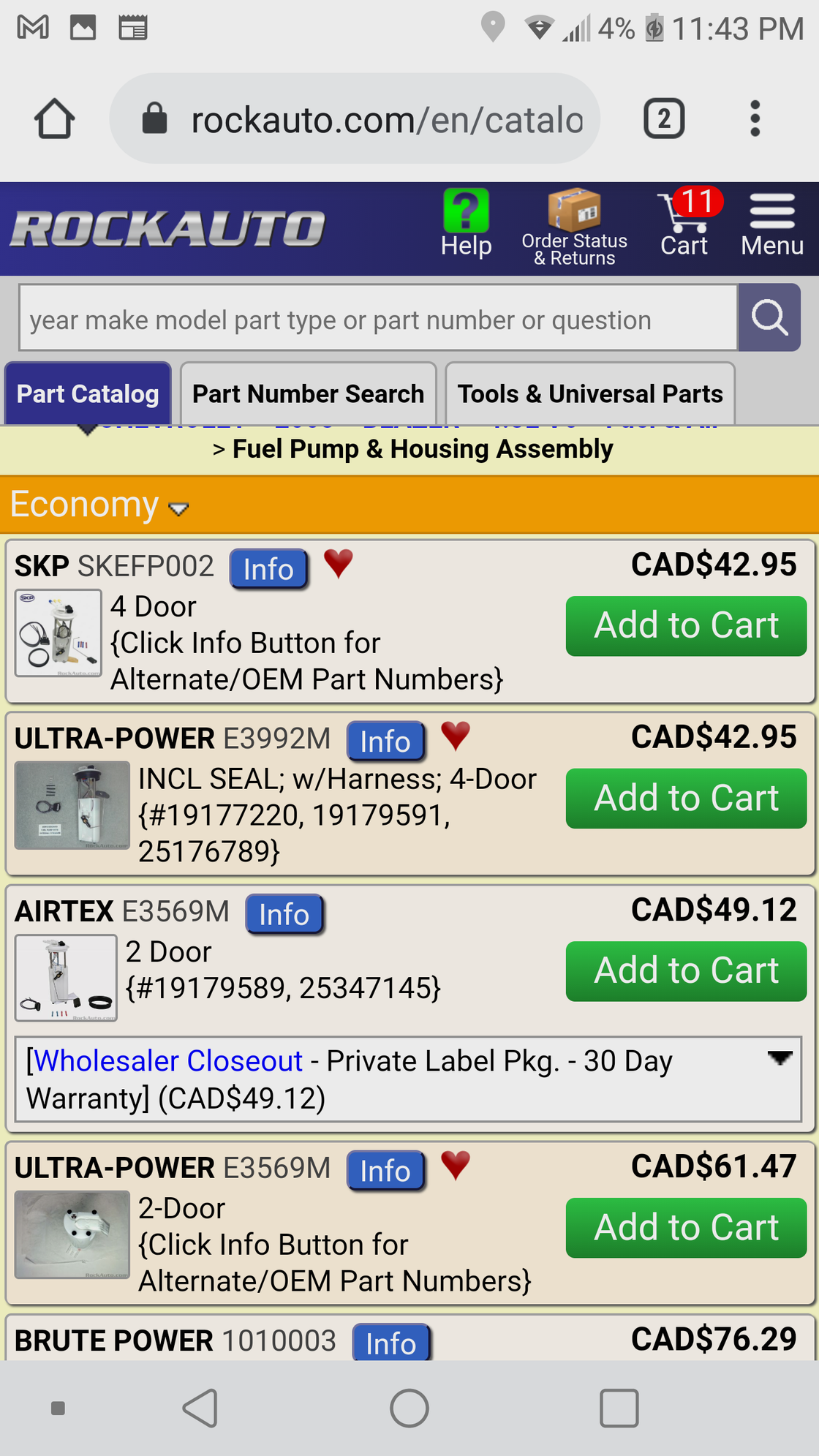

Sometimes when I'm driving my fuel gauge will go down really fast and if I put it in park it will go to empty but then if I shut the truck off and turn it back on it goes back to where it's supposed to be do you think it's a bad fuel sending unit? Also can I just change the fuel sending unit and not the pump as RockAuto sells them for $87 it's a 03 blazer ls 4x4

1) Reference the first picture below. If the fuel pump has ever been replaced, there's a chance that the replacement fuel pump uses a different design mechanism for the sending unit (how it's clipped to the pump assembly). So if you order a sending unit designed to replace the one on a factory pump, it may not install onto an aftermarket pump assembly. I see this a lot working in an auto salvage yard; aftermarket fuel pumps (aftermarket parts in general...) that although will serve the same function in the end once installed, they're design might differ slightly, enough to where you can't simply rebuild it or replace small parts on it with good parts from an OEM unit or another aftermarket unit from another brand.

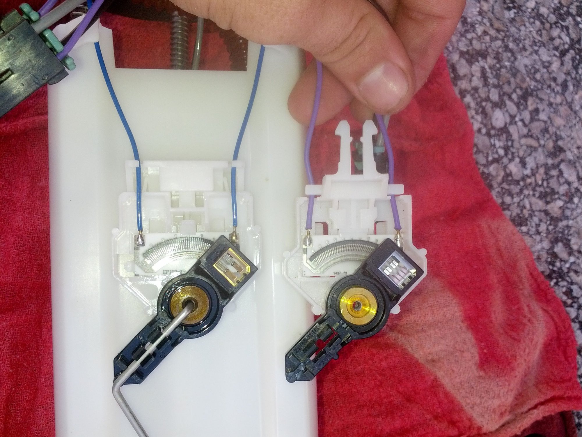

I went through this process on my 04 when I first got it. Had an erratic fuel gauge just as yours. I didn't have to rely on the truck at the time to get me around, so I had to time to mess with it. I dropped the tank and found that on the sending unit there's two small "fingers" that wipe across the contact board. Over the years those "fingers" wore out and were only making contact with the board every once in a while, which is what was making the fuel level gauge work sometimes and not others (see second picture below). Since I KNEW what the assembly looked like, I scrounged the salvage yard and found one that would work that looked like it was in good shape (3rd picture below; old one on the right, replacement on the left). So I installed that sending unit on my old pump, put everything back together, and low and behold it fixed the erratic gauge issue! The next week I started driving the truck every day, and all was well. Until about 2 weeks after that... The truck died on me in town, wouldn't start back up after running into a store. Turns out, the fuel pump went out... So I had to go through all that again and go ahead and change the entire fuel pump anyhow...

Would one of these 42$ units be a bad idea? It got a pump/assembly/sending unit for cheaper then what they sell just the sending unit and actual pump for
