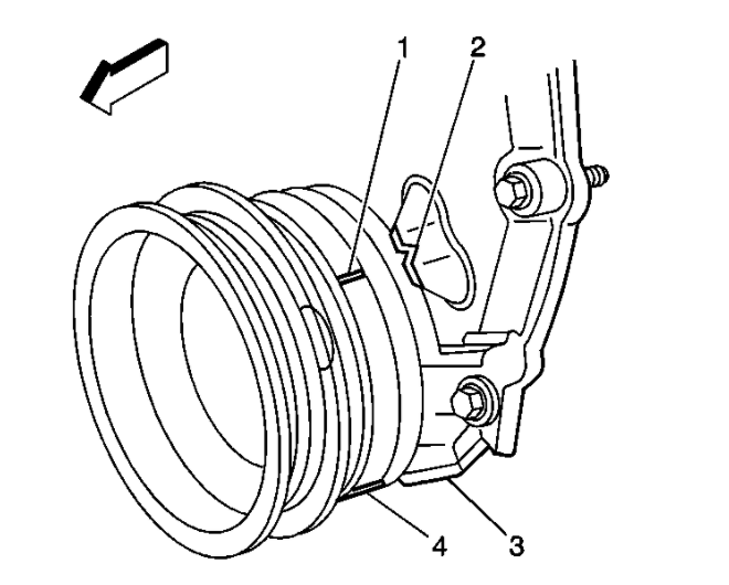

The easiest and most reliable way to confirm it's on the compression stroke, IMO, is to have somebody stick their finger in the spark plug hole while you turn the engine by hand. When air blows out, keep turning until the timing marks line up. Obviously, you want to make sure you turn in the normal direction of engine rotation.
BTW, there are a couple of different timing marks. Make sure you're using the right one. You'll still get spark from #1 regardless of how far out of time it is, so that isn't really telling you much.
