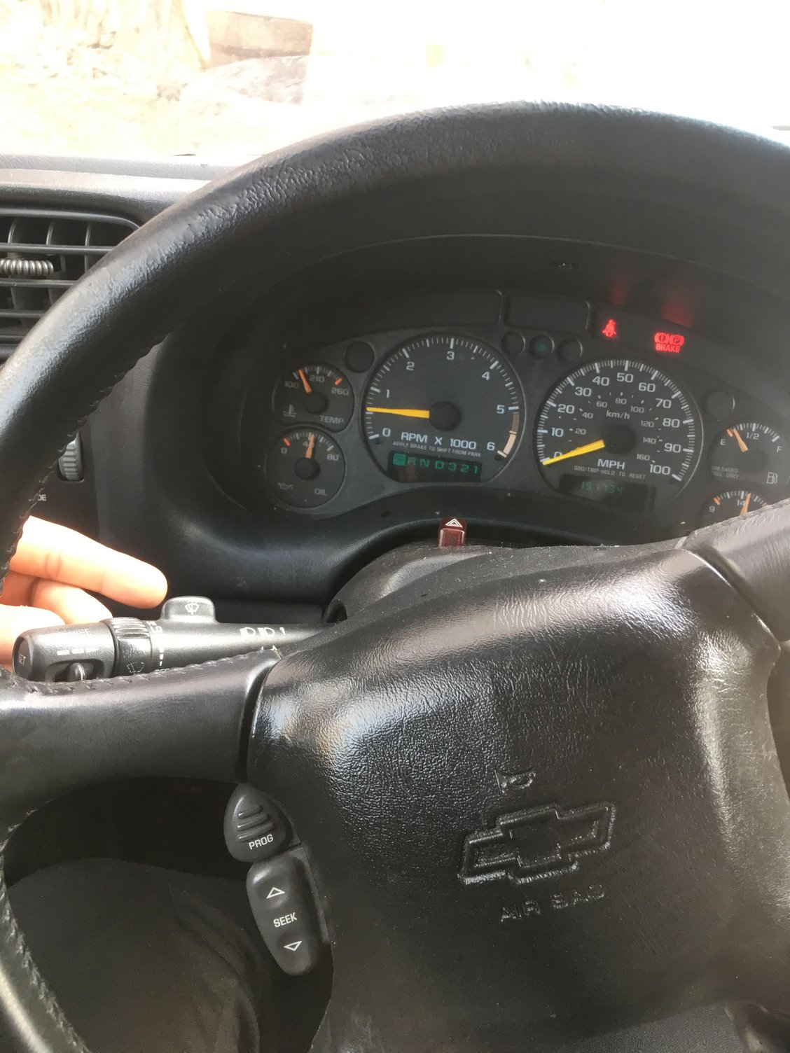

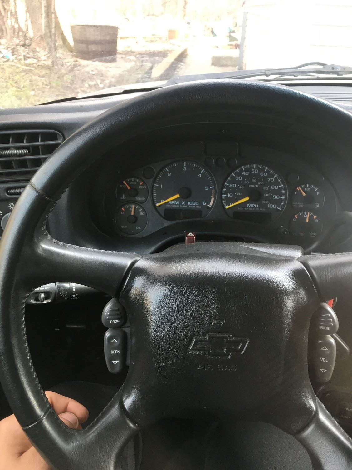

High beams off with truck on
High beams on and cluster works
Having some trouble with my blazer oddly the cluster and radio and inside light only work when I put the high beams on and if I have the radio on and all the light inside turned on it starts sputtering weird never seen this problem any help would be appreciated

My truck is 98 thanks for the response I’m currently replacing the turn signal switch . Maybe that can be a problem but I feel it’s not grounding I was thinking about giving a quick test grounding the negative to the body and seeing if I have a short somewhere . Yea it turns on fine sometimes it works but most times I have to hold the high beams in order for the cluster and radio also the heater to work
