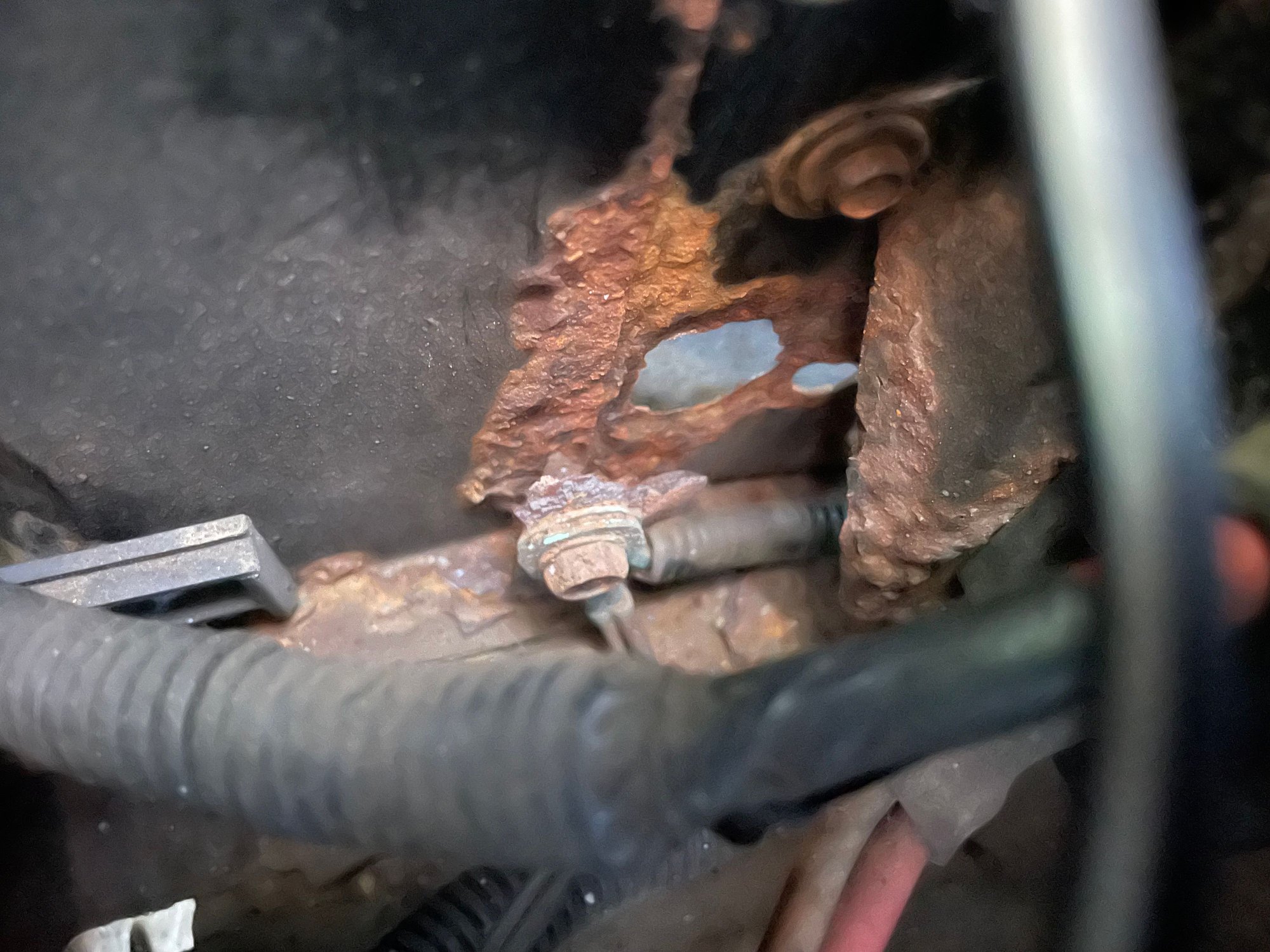

Just wanted to provide and update. Found this rusted out ground. Two grounds connected that rusted out. Located under the battery tray near the frame. Hopefully after repairing this, my issues will be resolved. Thanks for all the help

Good find, that should straighten out a few things.
