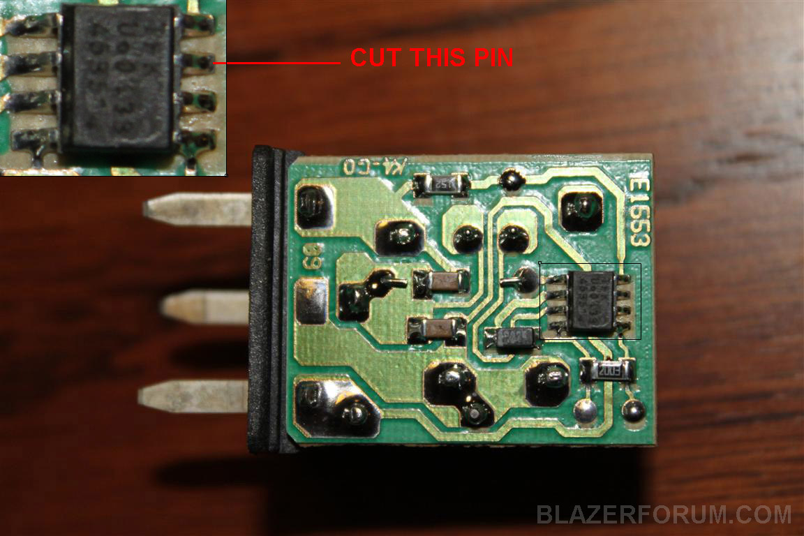

But after re-reading this whole thread, you may be looking for something that isn't there. The flasher module does both turns & hazards, but the hazards use a circuit within the flasher module. You could try modifying your current flasher by disconnecting the 2nd leg down on the chip as shown in the image I just took & edited of a stock flasher (attached). Disconnecting this pin should eliminate the bulb check functionality used in for the turn signals.
