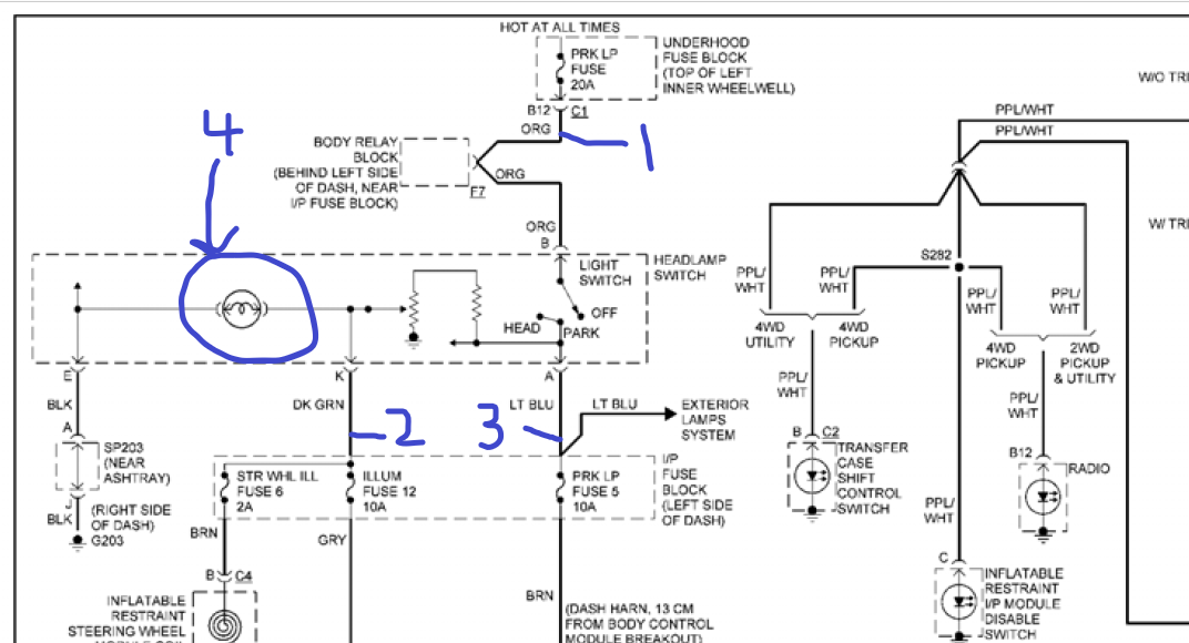

You appear to have more than one thing wrong regarding your IPC lights, dash lights and switch lights (ex: door switches for locks and windows). Here is the circuit section:
You verified 12v at the Park LP fuse in the UHFB (point 1) which makes sense since you have parking lights. This means that the headlamp switch has power for park (not shown in this diagram) and illumination bulbs. There are two outputs from the headlamp switch for illumination bulbs, the dimmer output (point 2) and the non dimmer output (point 3). You have no output at point 2 (IPC, dash lights, etc) so the dimmer function is broken and the headlamp switch needs to be replaced. You do have power out on the non dimmer circuit at point 3 for things like the door switch illumination bulbs but those bulbs don't work. Either every bulb is burned out or there is another circuit problem. After you get the HL switch replaced and hopefully get your Instr Panel lights back then we can work on the non dimming leg through point 3.

What's the symbol with the circle and curvy arrow in the headlamp, to the left of the 2-wire?
If you mean #4 in my new drawing that's the internal illumination lamp in the headlamp switch assembly.

Oh, I see. I just took the switch apart and it looked like a bullet.
I figured it was a light or something.
