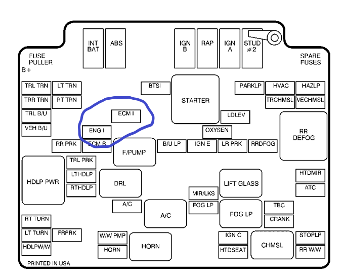

ECM1 has 6V on it and right next to it in the UHFB is ENG1 with 12V. They are both fed by the same circuit and the wiring diagram implies that they are connected under the fuse block which is why I expected you to find corrosion in that location:
Since there was no damage under the UHFB then they must join further back so follow the wires under the UHFB from the two sets of socket pins back towards the power source until they join. Something is wrong between those two points.

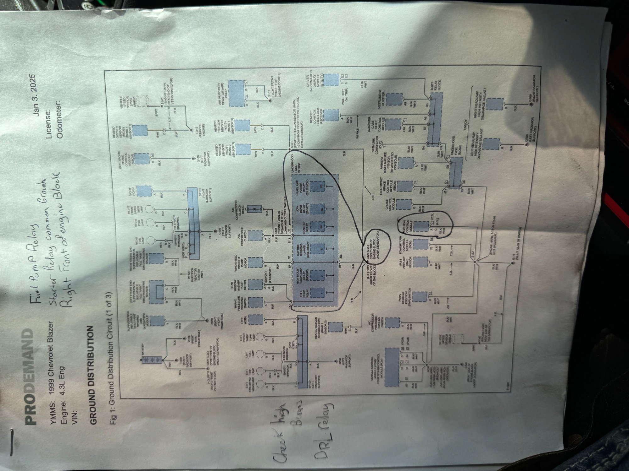

I finally figured it out, the starter relay and fuel pump relay share a ground it was burnt up somewhere along the wire still haven’t found where yet, but I made a jumper ground to the body from the relay pins and now cluster and everything is working and cranking again, now just have to figure out no spark
