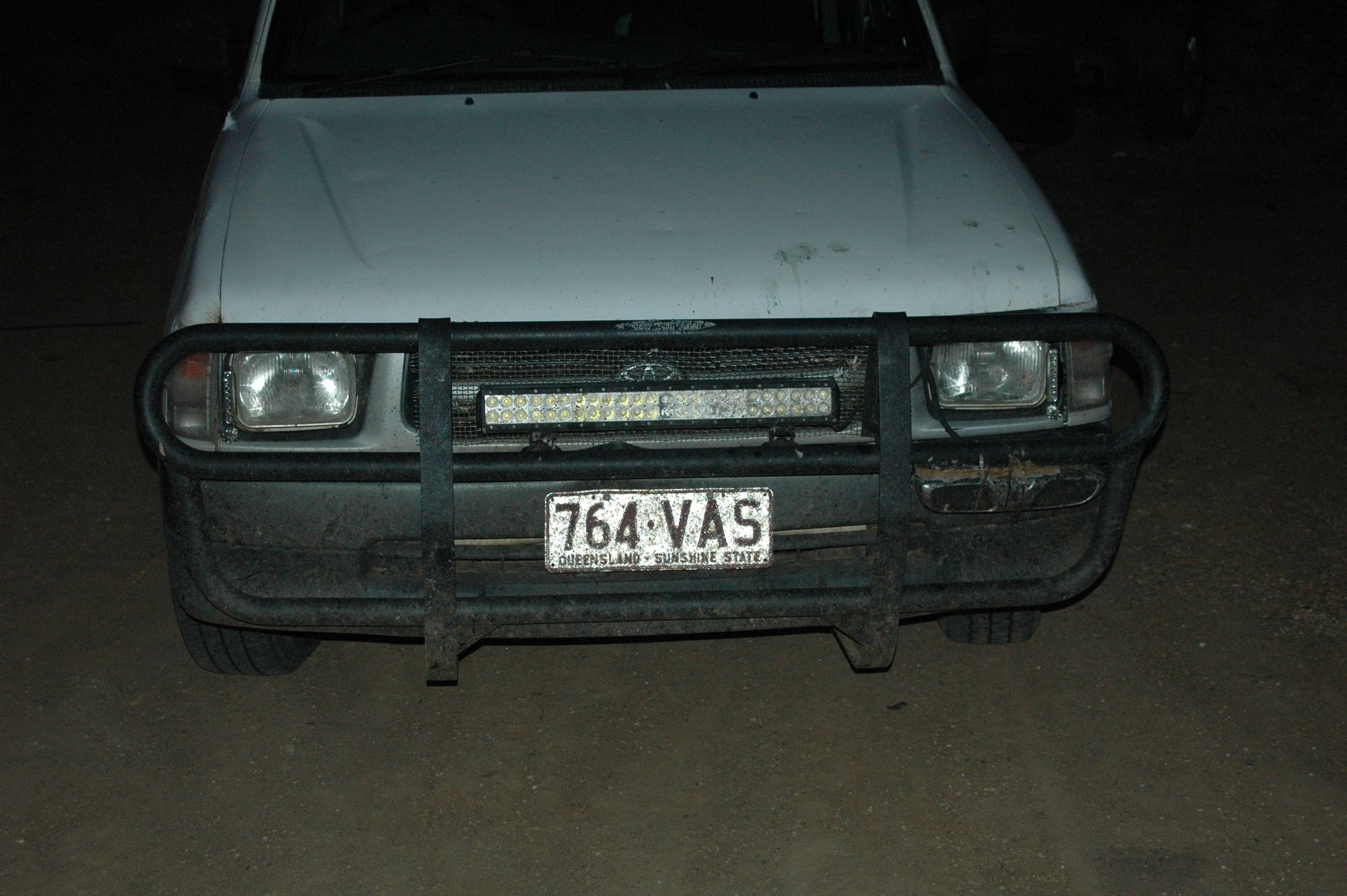

folks, I mean any after market lights, mainly on the front of the vehicle, you can also add them to reverse lights, work lights on the side as well, but mainly on the front, heres photos of 3 of mine 1st is the curved light bar on the coaster bus motorhome, the 2nd is the Hilux, and the 3rd is the cruiser, the cruiser has 4 HID spot lights added as its old school. the Blazer hasn't any on it yet, as they are still coming.
on the front right under the light is whats called a Roo Shoo it emits a high pitch sound that you can just hear but Roos can hear it a 100yrds away easy it has tweeters in it and runs at around 15000hzz dogs hate it as well
this has 4 spots 2 in the middle and 2 outside all hid
