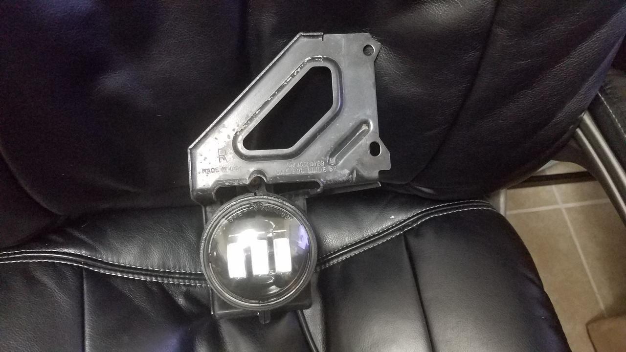

Took a break for a while, but recently decided to load up 123D Design and model up a bracket for a little project on my other cheap daily. On my little 1998 Saturn SL2, the headlight and fog light output is just terrible... I've sanded and buffed them all, and that helped a little, but I'm going to HID projector retrofit some new headlights to get some better output from them, and for the fog lights, well I stumbled upon some aftermarket LED fog light pods in the front bumper of a Jeep Wrangler at the junk yard, and they were sized too good for me not to try it.
After a lot of measuring and some eyeballing, this is what I came up with. A simple 2 piece bracket assembly that screws together around the LED fog light, holding it in place and creating mounting locations that mimic the original fog light, so the whole assembly can be mounted to the factory Saturn fog light bracket, even retaining the factory aiming ability.
Got one printed off already and assembled, the other is printing as I type this

My LED fog light bracket project came out great
