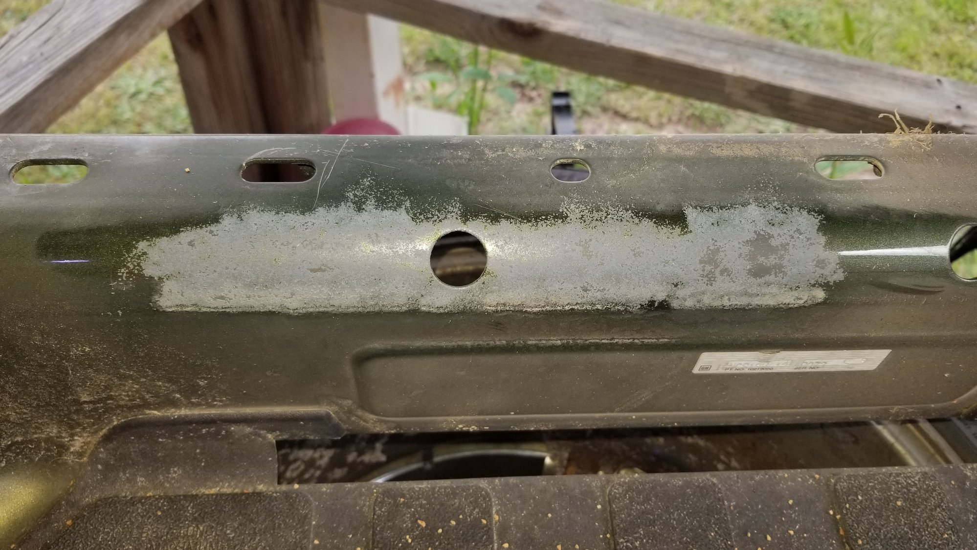

Ok so here's what I got.
An 8 gallon, 150 psi, Briggs and Stratton air compressor, a $5 blow gun from Harbor Freight, a box of ground walnut shells, and a 20 oz. Mountain Dew bottle. I carve a notch in the barrel of the blow gun, then drilled the hole in the bottle neck as shown in the YouTube video.
I can't stress enough how important it is to wear protective gear when using something like this. I had on leather gloves, a full face shield, a jacket, and jeans. Next time I will wear a heavy apron.
Here are the results.
This took almost two bottles of media, but only seconds to accomplish. This is a bumper I pulled from the boneyard to replace the one on my 02.
