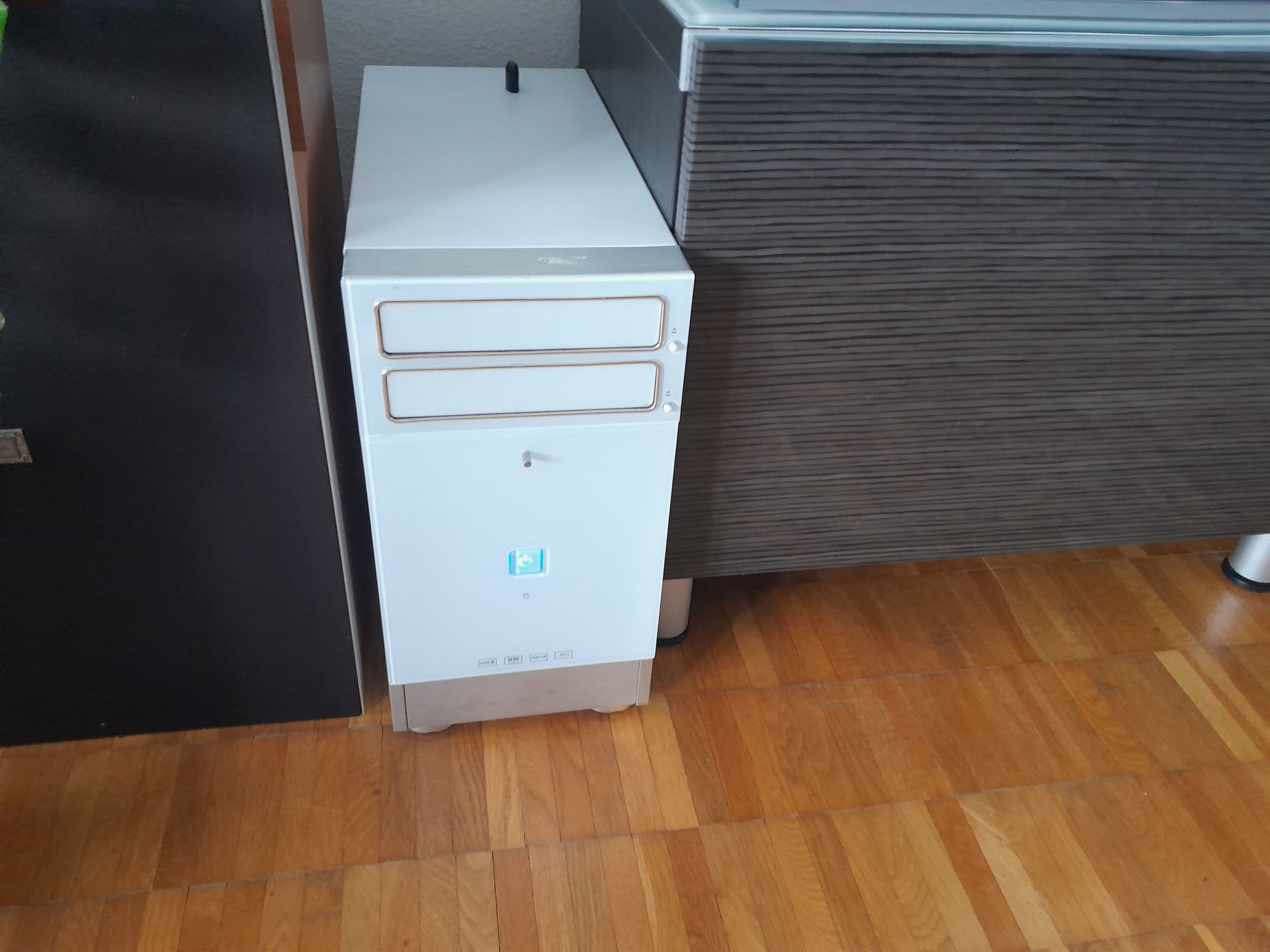

Default Take about 5 make 2
Been a while since I built my last PC.
Sometimes customers for whom I do network support have me get rid of their old hardware and take care of data shredding.
once shred, i take what i need.
First build was a linux box with 16 GB RAM on an i3 Processor a 256 GB SSD and 640GB HDD for multimedia station.

and the pics
hooked up to my TV and my old REVOX Amp
