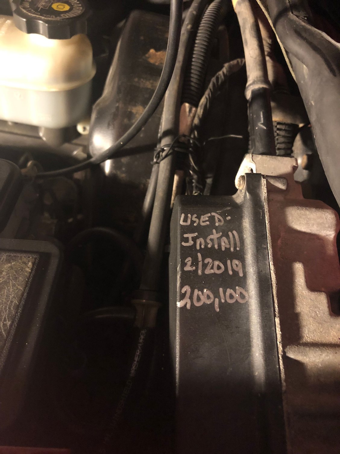

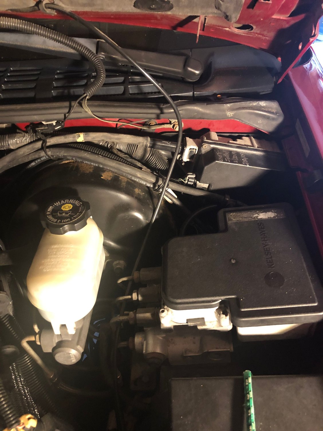

Cruise switch is on turn signal wiper multi switch. You can add one but it’s not just straight forward plug and play. I do believe the body control module computer (BCM) has to have the information telling system you have cruise. There is a brake switch which is inline with the system and then the actual cruise module under hood.
Upper right corner cruise module.
My habit, use marking paint pen to note everything under hood, easy to find when I need the info.

Ohhh that looks pretty involved. The pcm, abs, and basically everything else is different as well so I'm betting it doesn't have it
