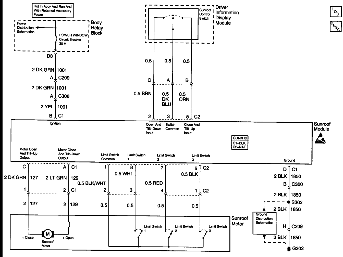

I own a 97 s10 ext cab and i have a 2001 factory sunroof and switch/head liner module i'm trying to install but i need a wiring diagram and instruction on wiring up my fuse box i suppose to make it work. if i could get a vin from an owner of a factory sunroofed blazer it would be greatly appreciated. I was going to go to the chevrolet dealer and ask for a schematic or diagram i guess it would be called. perhaps someone could give me an idea on their wiring set up or give me info on how their sunroof works. does it move up before it retracts? does it move straight back only? does it tilt as well?

The factory sun roof will vent when the switch is pushed forward, roof closed. The roof will open when the switch is pushed back which will lock the roof into the retract. It will drop down slightly at the rear and then retract back under the roof, above the headliner.
Here is the schematic from a 2000 Bravada (same as Blazer/Jimmy):
