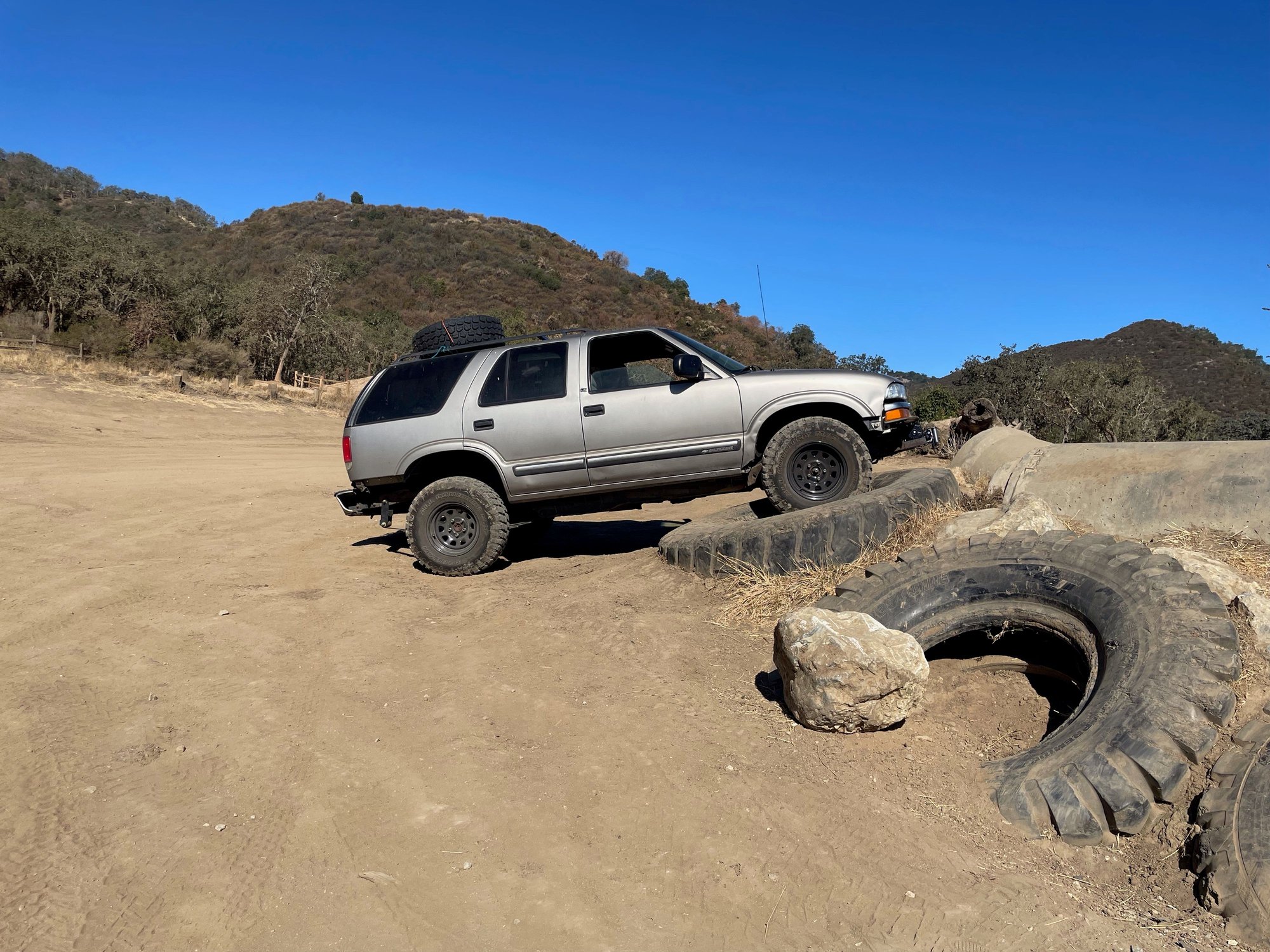

I installed the 2.5 in lift im wondering if i should upgrade to the ZR2 axles

i guess i should have specified im wondering about the fronts almost seams like the front axles are a little short now im wondering if the ZR2 are longer
Old Jul 30, 2022 | 02:58 PM
Yes the front cv axles are longer in the zr2

Np. Nice ride btw... any other plans with her?

just LSD in the rear and eventually im going to go with the 6in lift and 35s full SAS

Just to chip in to clarify, while you can swap the wider ZR2 rear axle, the front diff is physically identical (other than the rare iron case from a manual transmission ZR2). The main reason to swap the front diff is if your existing front diff has a different gear ratio from the ZR2 donor. You cannot swap the longer ZR2 CV axles into a normal Blazer to make it wider. They won't fit. The extra front width on the ZR2 comes from frame differences and wider mounting points for the control arms.
