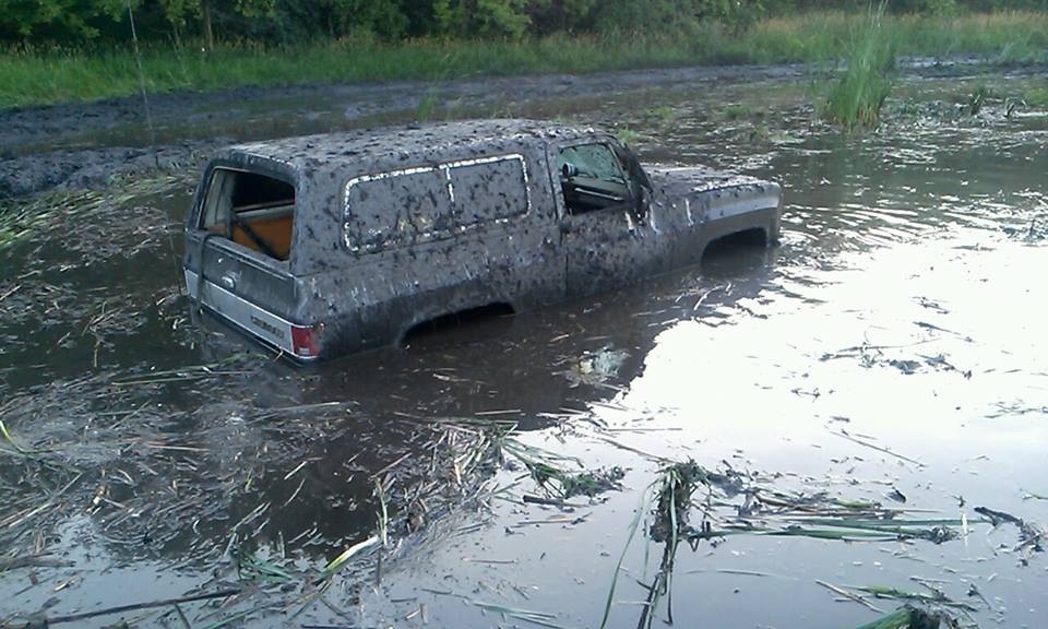

i got a good one for you guys lol. i took my truck to a swamp party. i took it out to a buddies swamp party. took the truck down the back straight and got stuck when the truck popped out of 4x4. then i tried again into a really deep hole. and made it nowhere lol. water was a foot in the cab and engine died. i just ended up getting pulled out by a tractor and pulled all my plugs drained the oil and let her sit for a while. the starter was so wet that it didnt wanna start the truck. i got about 5 gallons of water and oil out of the oil pan. but i still ended up driving her home. good thing i had an extra 5 quarts of oil in the truck!!
first picture was after getting pulled out of the first hole i got stuck in and the second pic is the hole that flooded the engine lol.

nice, i had a few k5s that i used in the same way and they always looked like that first picture. it would turn more heads then any sports car. just sucked cause it made a mess in the driveway. with the older trucks like this you can pretty much swamp them up to the spark plugs, as long as the air intake and distributor dont go under it will stay running
