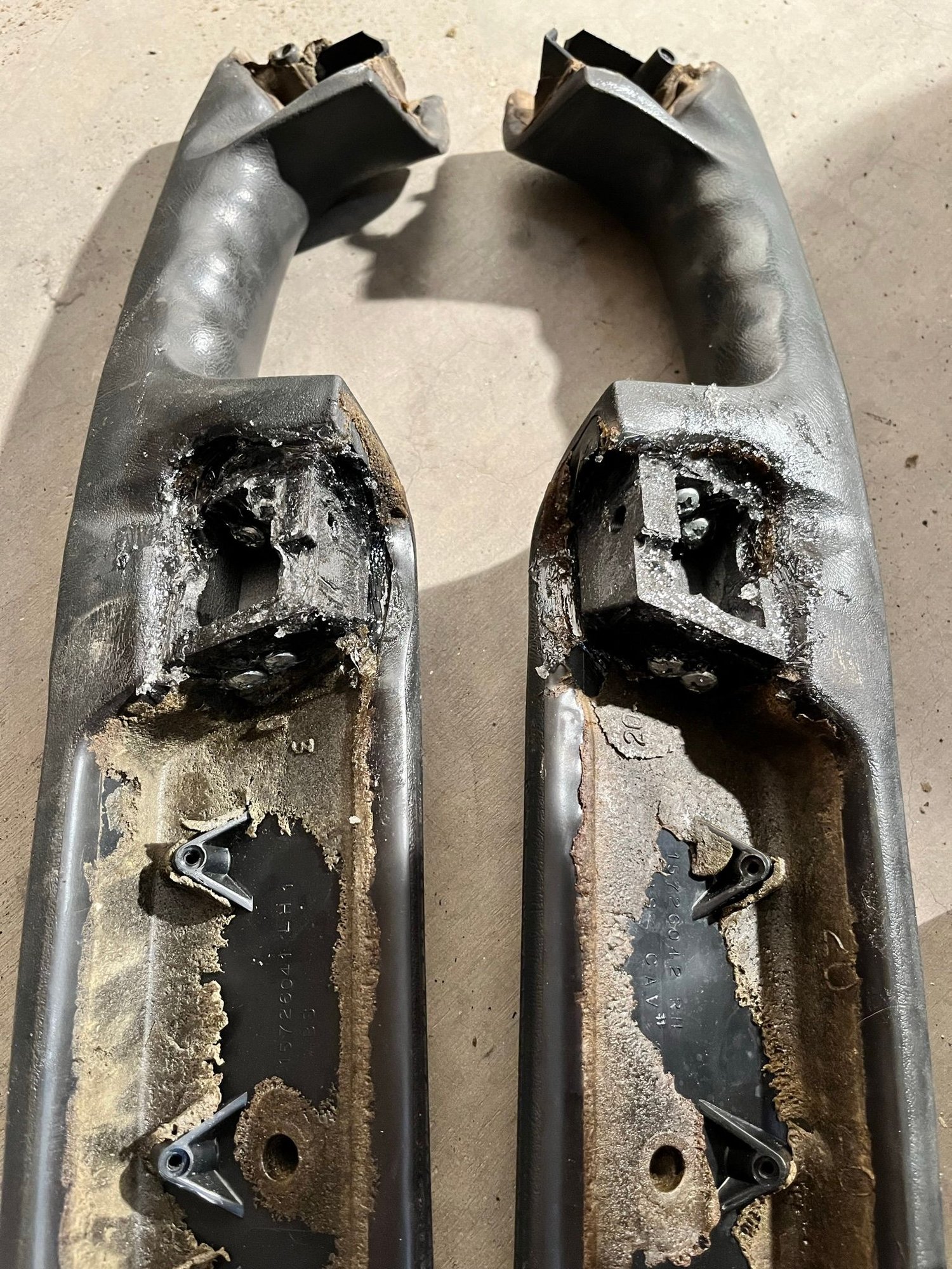

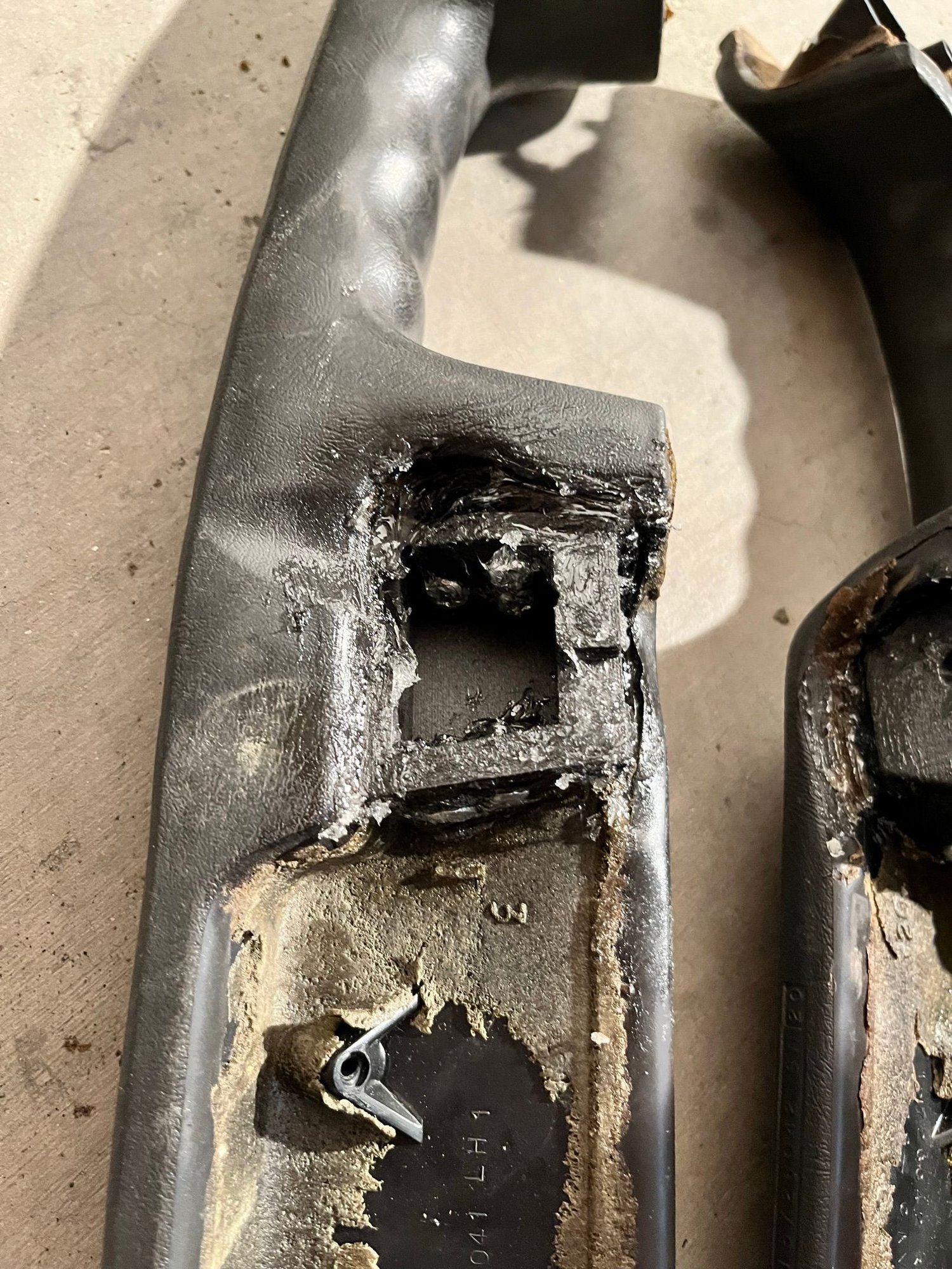

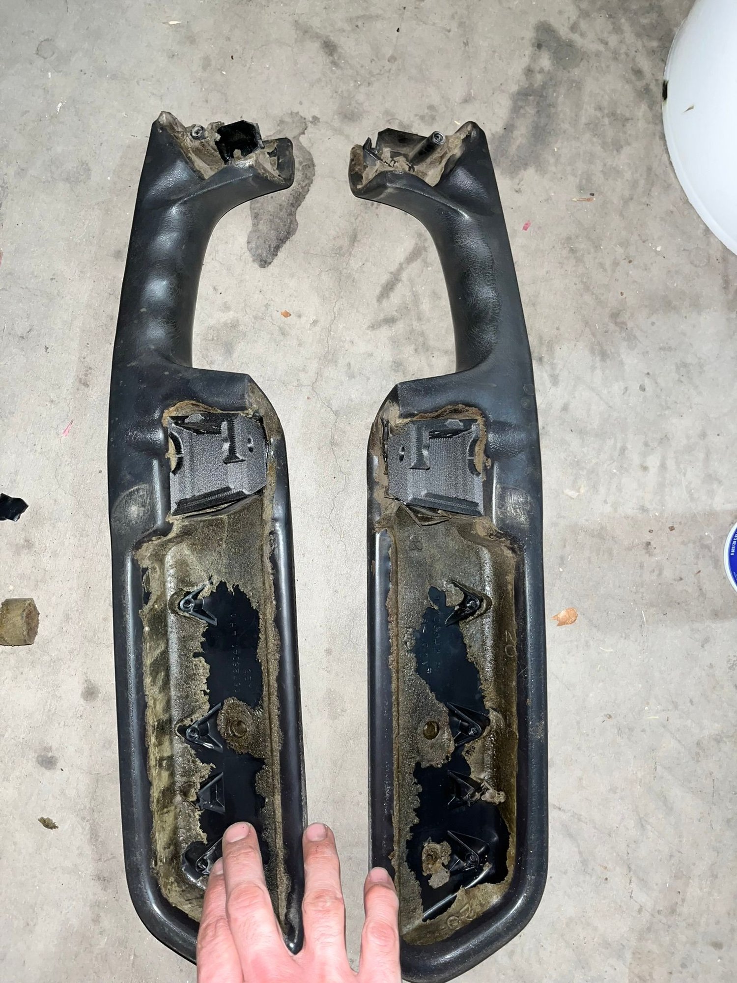

When I got my 2000 LT, all the door handle mounting brackets broke to bits, so I 3d printed a block which is adhered into place with self tapping screws for additional support.
placed without any additional support
Use clear silicone
add additional support
PM for 3D file

It took me a moment as your After pics are first and the Before ones were last. LOL

It’s in order, it just looks messy after adding the clear silicone
it’s held up great!

yes but I already work a bit I would be happy for someone else to do it but it should just be open to anyone that needs it
also locally you may find a service to print it for you OR there are plenty of online services which can
just know you must print 2x pieces and also mirror one
I’ll consider posting it on our works Shopify
