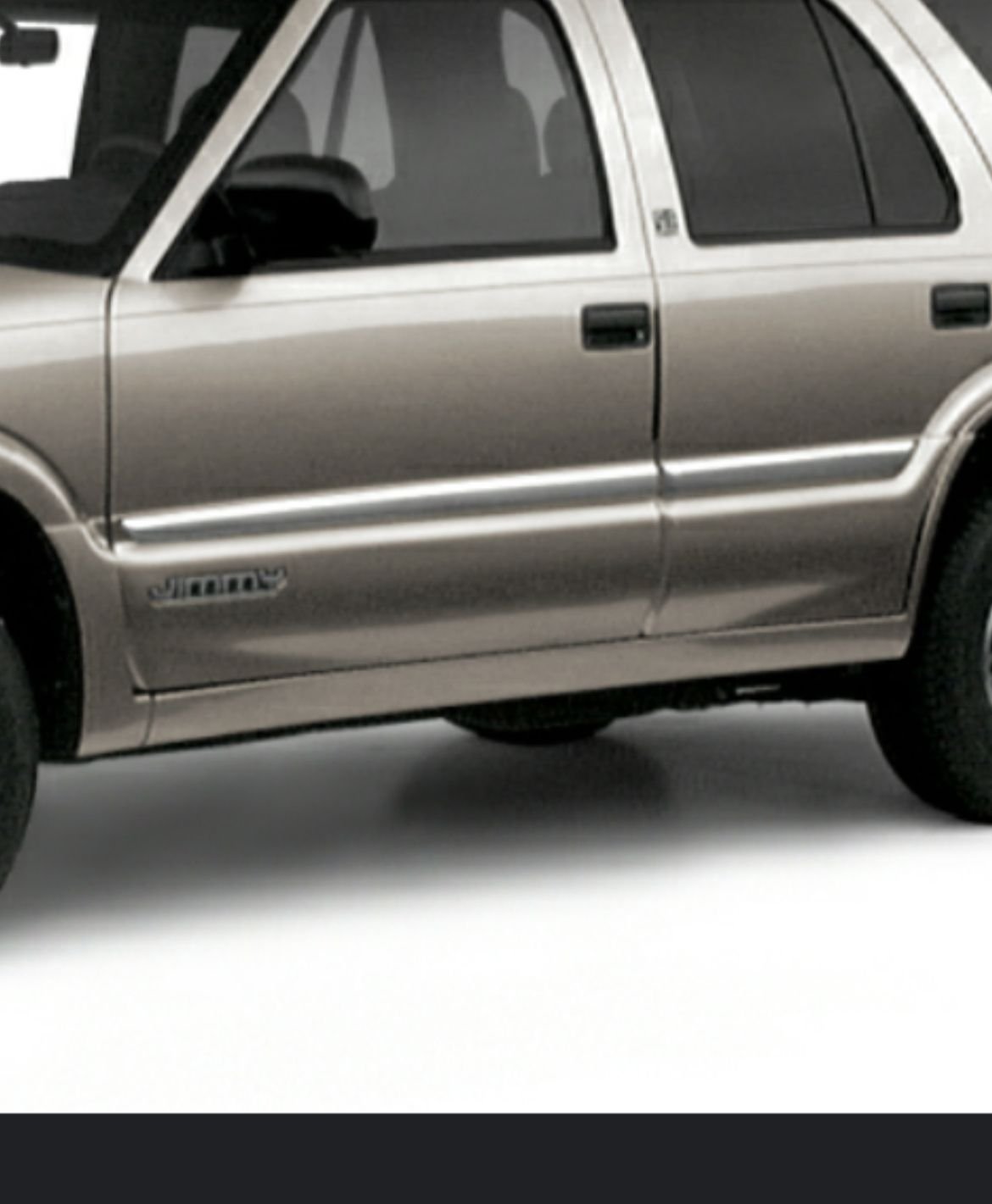

No there not aftermarket they are stock on jimmys and bravadas. Heres a pic, Im trying to find out how they go on, i think they get riveted in???
The section that bulges out on rockers and bottom of doors

I call it molding or cladding. The cladding at the rear wheel well towards the bumper is removed with several nuts and bolts. Likely the rocker and door covers are the same.
The rear cladding has 3 - 7 mm screws hiding behind the mudflap, and 4 - 10 mm nuts underneath the rear quarter panel. There is also a bolt near the bumper securing the corner of the cladding to the frame.
So the screws fasten to the exterior face of the cladding whereas the nuts are found on the interior side of the cladding.

Thanks!
