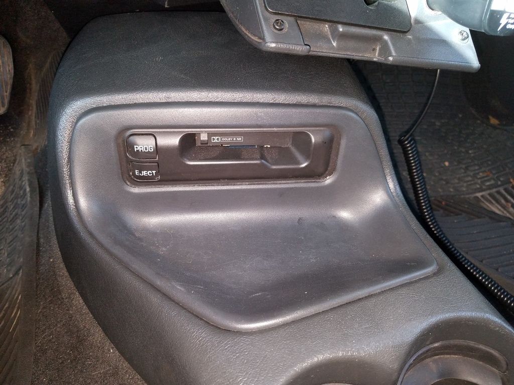

I still have yet to install the passenger side, that will hopefully happen next weekend. I'll get some photos of the airbag removal, and some more detailed ones of the bracketry construction. For now, the only other step I've taken was to mount the new console to the floor.
