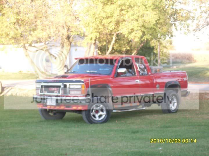

one of my friends had little 12" or maybe 16" whips on his front bumper of his gmc pick up, it looked really good actually to me at least. He called them curb hitters (even tho i think there backwards for that lol)
you can see it on the drivers front in this pic
