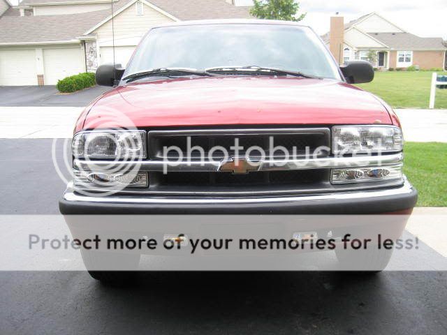

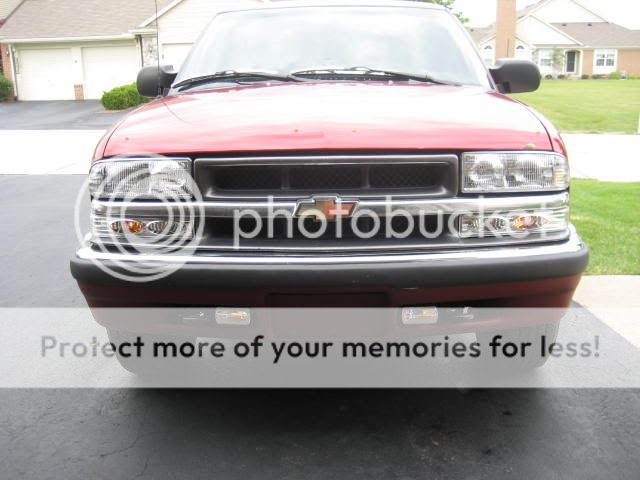

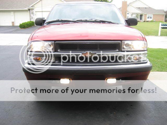

Bought these saturday night got them today.
http://i277.photobucket.com/albums/k...rew010/383.jpg
http://i277.photobucket.com/albums/k...rew010/382.jpg
http://i277.photobucket.com/albums/k...rew010/381.jpg
http://i277.photobucket.com/albums/k...rew010/380.jpg
Bought them for $5 on ebay, sucks i had to pay tripple of what they cost for shipping. tell me what you guys thinks.

I suppose it is the bumper lights we are looking at? $20 overall is not bad for the pair. Make sure there is a vent of some sort so they do not fog up. Also, your driver's side headlight is mounted incorrectly. Pull the grille off and make sure the headlight tabs are in the slots instead of resting outside them.

Yea the clear corners. They have a vent hole predrilled so im good on that. And i'll have to fix that headlight asap!
