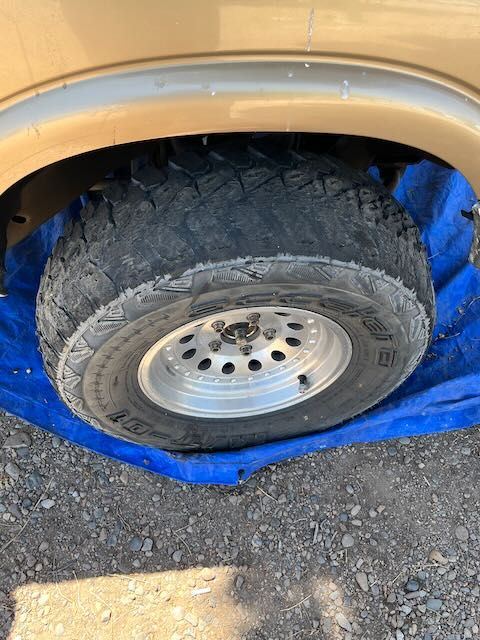

I need to disable the steering wheel lock for my 1999 Blazer, 4x4, Auto, 160K. It is my TOAD vehicle, yes I have a driveline disconnect. Last trip I the wheel locked, on its own, in a turn and it ended up costing me a tire.
While diagnosing the key lock I was able to make it lock. I can't afford to damage tires again. I want to disable the steering wheel lock forever while maintaining the key start. It used to be much easier, I did it years ago... can this still be done?

I was flat towing my rig. To do this the steering has to be unlocked without power. There are four key positions, not counting backwards for radio only. They are: off or locked, unlocked without power, unlocked with power, and finally start.
I had the key in position 2 unlocked without power, and at some point it locked in a turn and destroyed the tire. This is beyond unlikely if you are driving because the key will be in position 3 by default. Don’t sweat it. However if you frequently flat tow your rig I would immediately disable the steering lock.
