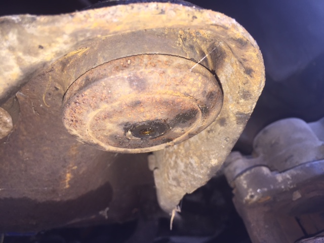

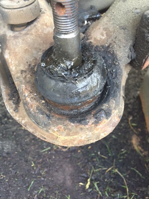

Hey guys, can I pls get some eyes on my lower ball joint to see if this is one of those that can be pressed out or if I need to replace the whole control arm with it? the pic with the stud is the top of the BJ and the second pic is from the bottom. I have about 140K on the vehicle. I appreciate any help in advance and pls let me know if there are any other details I can provide. Thx.

Press out from the top down. Now is the time to invest in some longer ball joints. They will correct many design flaws of the original G body. HOWE makes them but they are expensive. My opinion; worth every penny.
