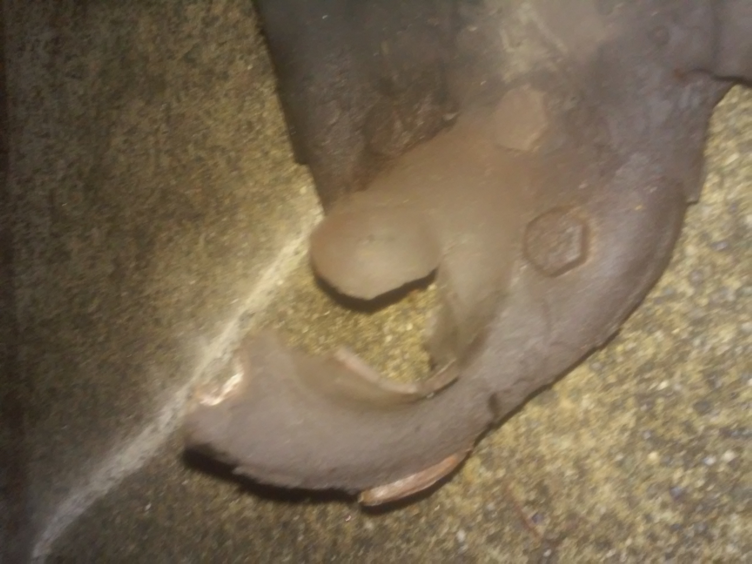

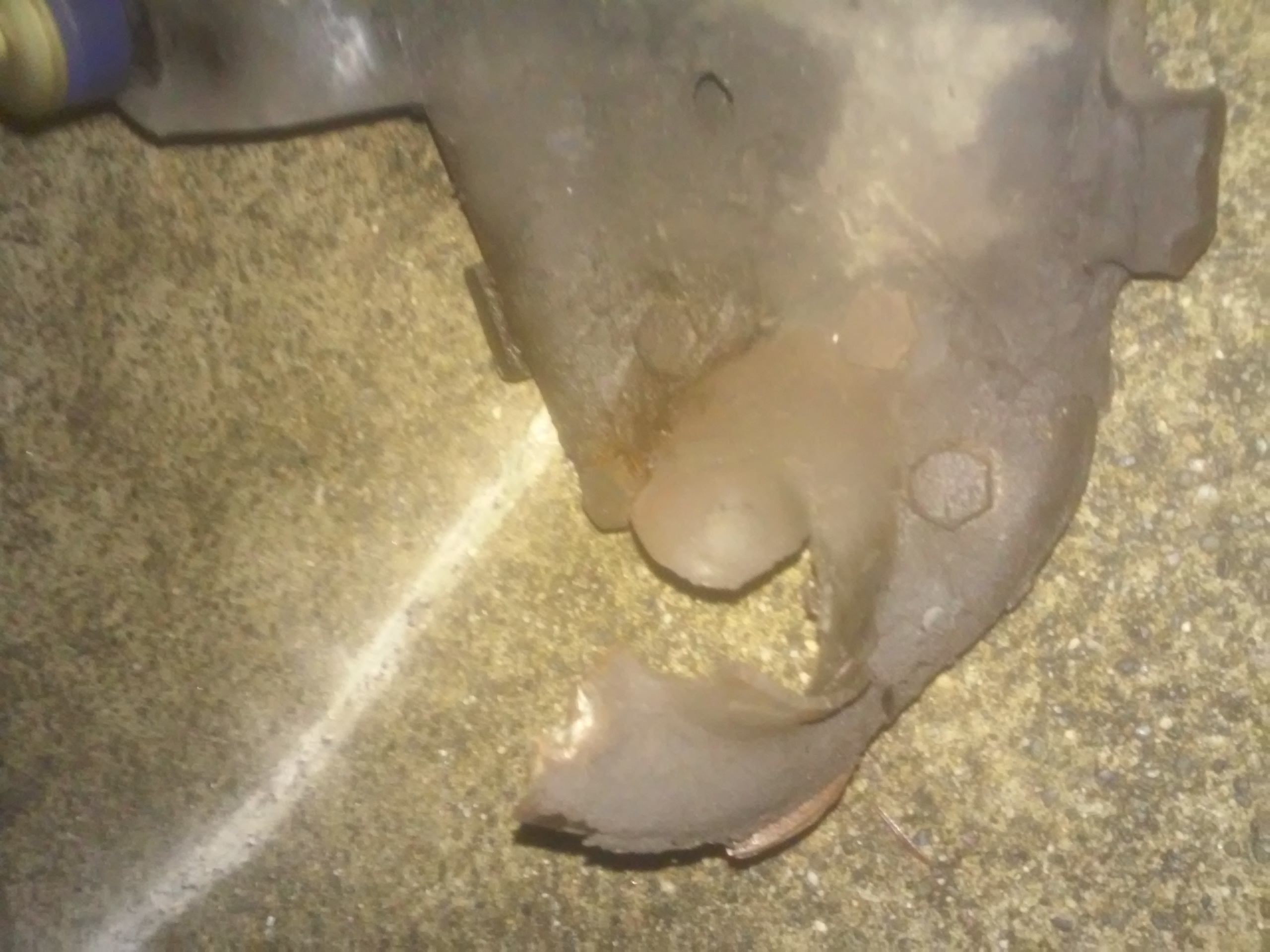

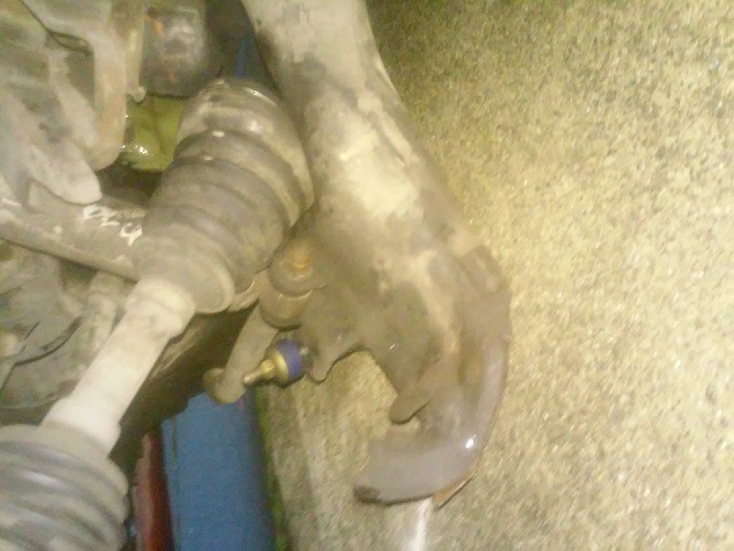

I was reversing out my driveway and my front driver side wheel dropped to tha ground and I knew it wasn't a flat tire. I need help on what I need to do to replace my lower control arm. What tools I need. How many jaxs will I need to lift up. Do I need a super powerful c-clamps. My control arm totally ripped off my tire. It's ugly. Fluid was leaking, what is that. Do I fix that too? Plus do I fix tha ball joints.

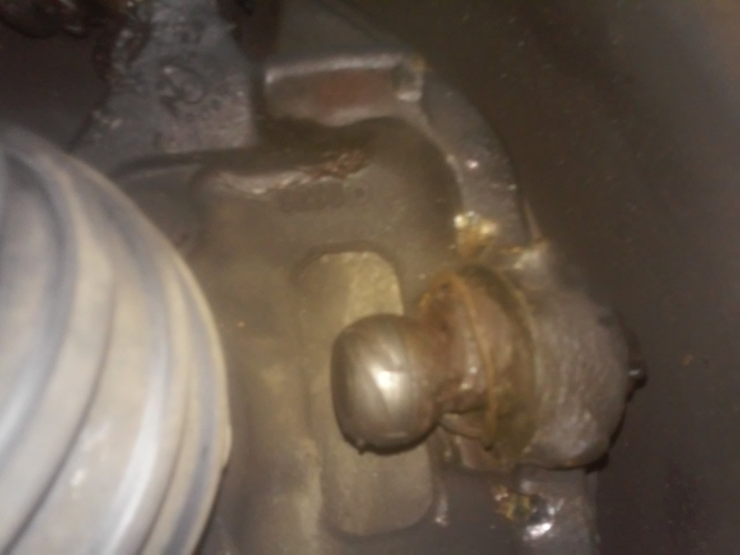

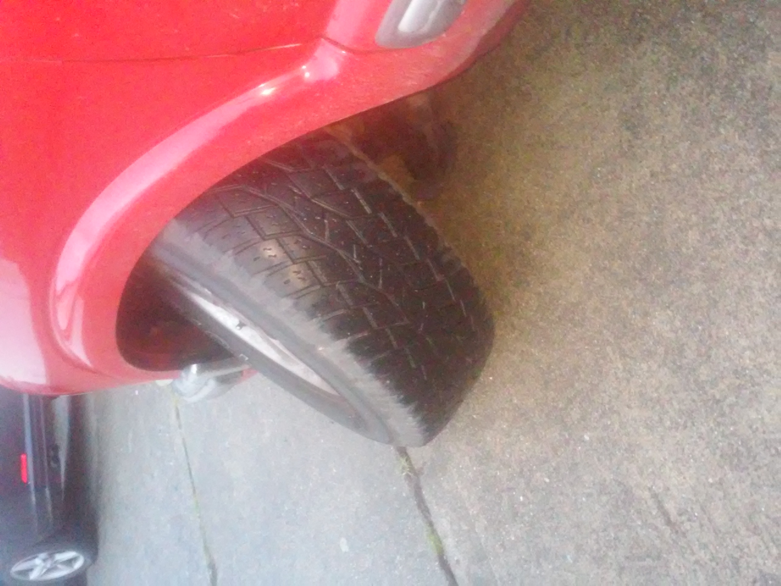

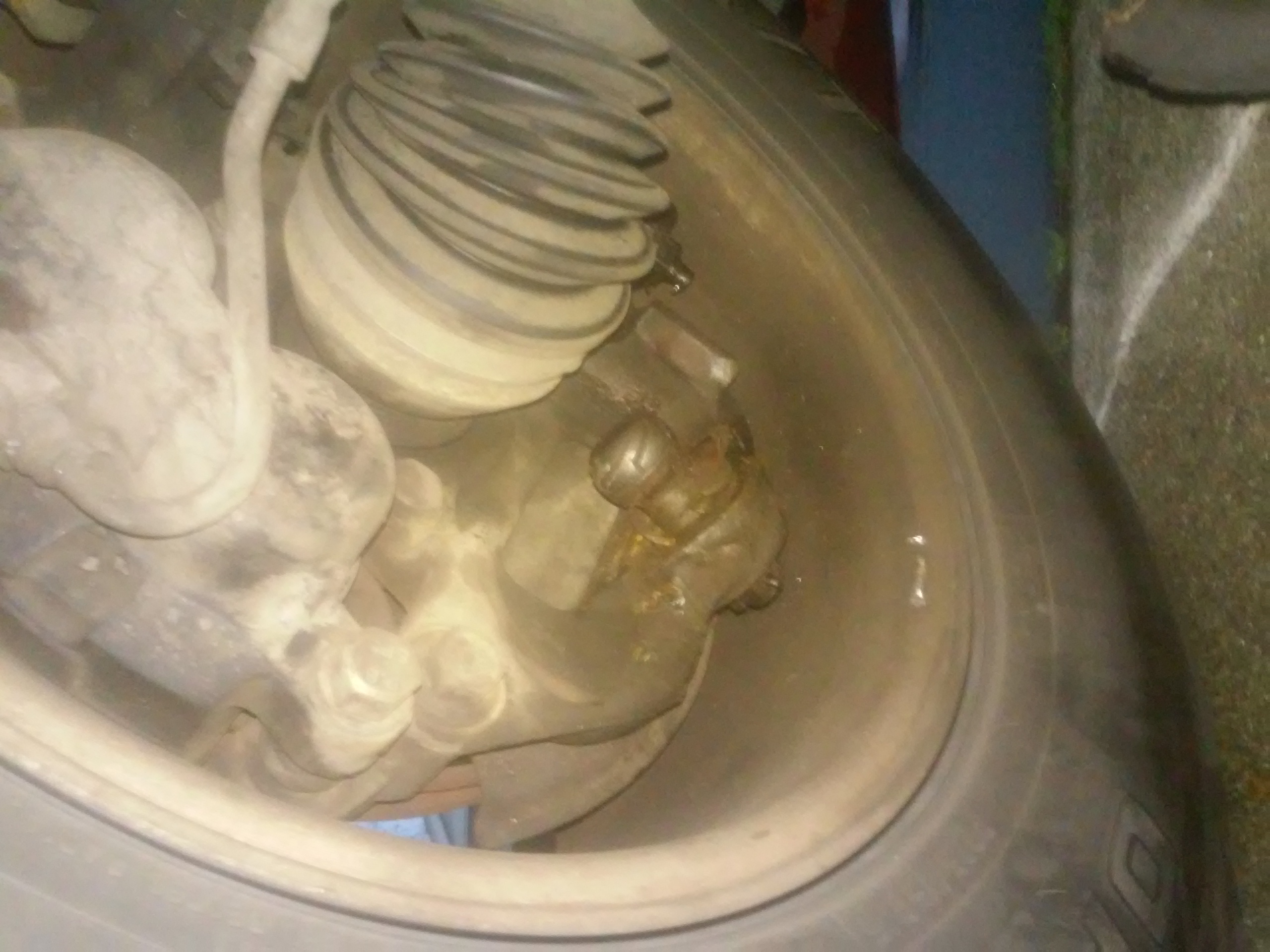

Here are pictures of what happened.

This truck appears to be 4wd and they cant use a spring compressor. I would say by the looks of damage what is needed most is two cans of penetrating oil, a BFH and a MAPP torch. Unscrew the jack screw in the cross member first.

Also tha tow truck driver said he went to Bates School for mechanics and he looked at it and said I also need to replace tha cv joint. There was fluid leaking bad.
