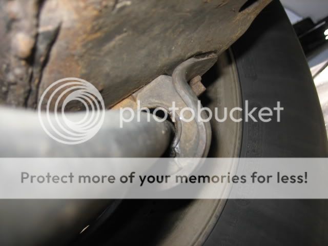

Well, after thinking that something couldn't possibly be right with my front end, I went underneath again and checked a bit deeper. Here's what I found:
You can actually see right through those gaps. These are the things where the sway-bar mounts to the control arms, what are they called? I kinda doubt they're supposed to be like that and its probably explaining my clunkity-clunk-clunk. What do you think?

Those would be sway bar bushings I do belive. That could be making some noise, the bar is supposed to be held much tighter by those bushings.
Old Mar 18, 2010 | 10:01 AM
Posts: 41,335
Yep, those are shot! While you are working on it, change out the sway bar end links too. They are cheap enough.
Don't forget to put some lube on those bushings when you put it back together or it'll squeak like mad!

Hey guys, well I just wanted to double check to make sure that it's most likely the sway bar bushings that are making the noise before I dump any cash into this. Somebody mentioned broken links but if I know what those are then my truck doesn't even have those. The swaybar is just mounted to the truck with brackets and bushings. Here's a picture of mine:
It appears the tire is rubbing against the sway bar too on sharp turns. It only seems to rub while moving since it won't touch while standing still.
It's the mount all the way to the far left (far right on the other side) at the end that is worn out (shown in earlier pictures).

Forgot all about this thread.... turns out that my torsion bar mounts snapped clean off the frame and as a result the torsion bars were banging around making that lovely noise. Happy to have fixed this.
