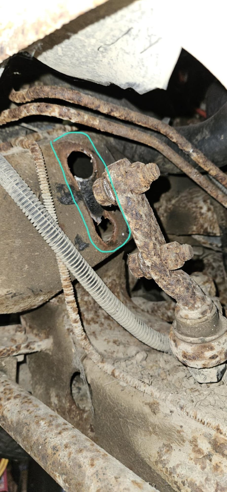

I was driving my '94 s10 blazer (sq body) through a somewhat tight bend.... I turned the wheel.... and nothing happened.. she kept going straight.. when I hit the brakes then it turned... .needless to say my underwear were almost casualties!
turns out when I tried to turn earlier with the tire against the edge of the asphalt.. it ripped the idler arm clean out of the frame...

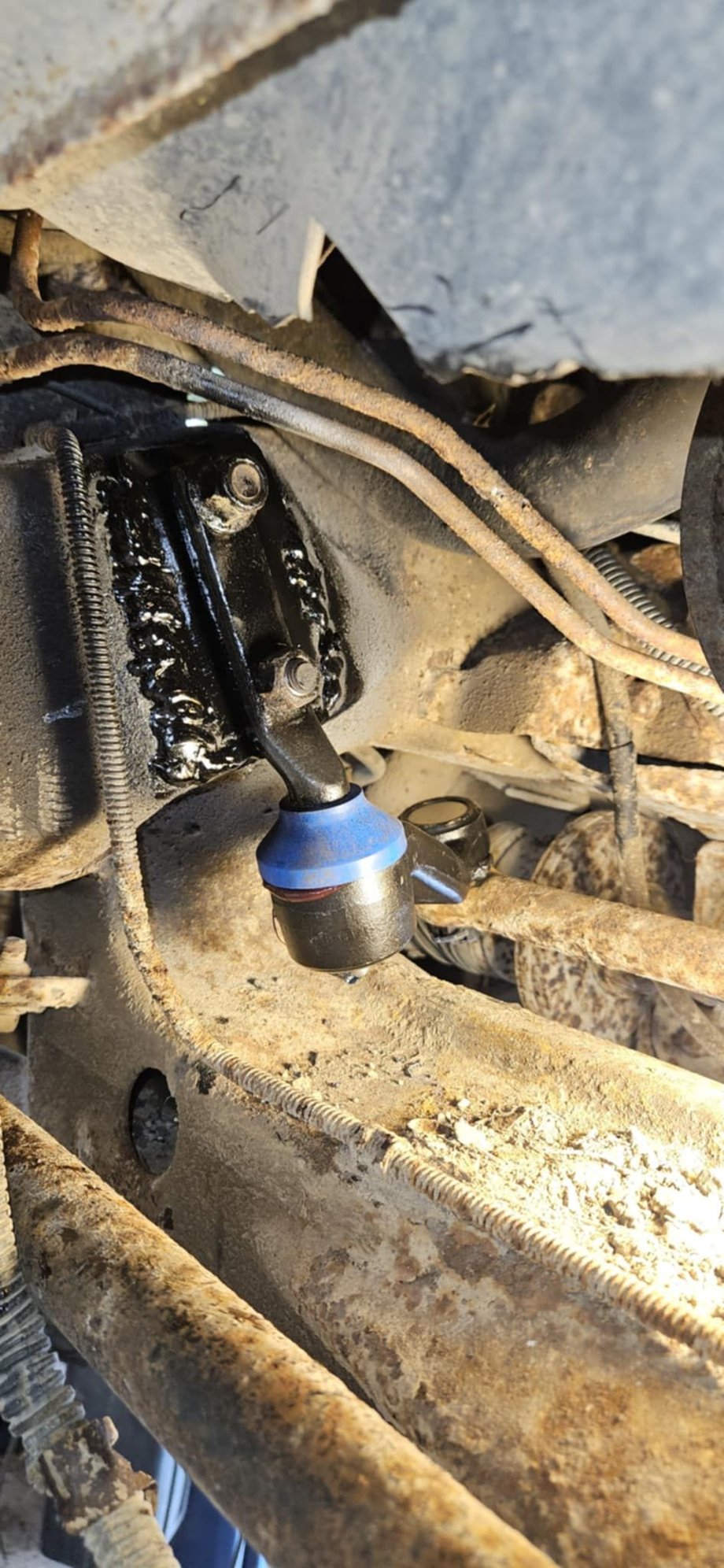

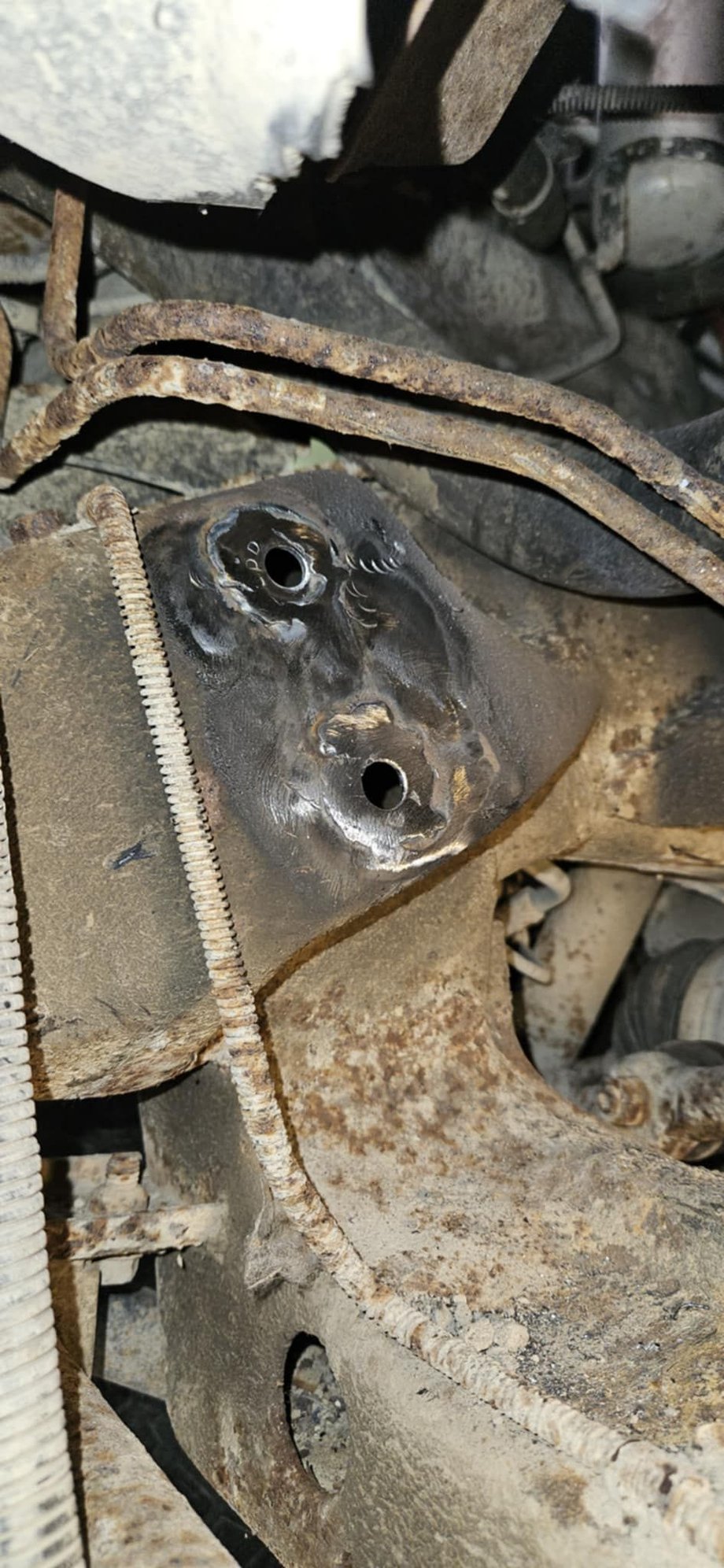

after thinking it about for a while and researching options (possibly doing the 1-ton idler arm upgrade?) I decided that since the holes were almost exactly the right size.. I opened them up just a hair with the die grinder and carbide bit, and welded a 7/16" washer back into the holes, then re-drilled the holes out to fit the metric bolts.

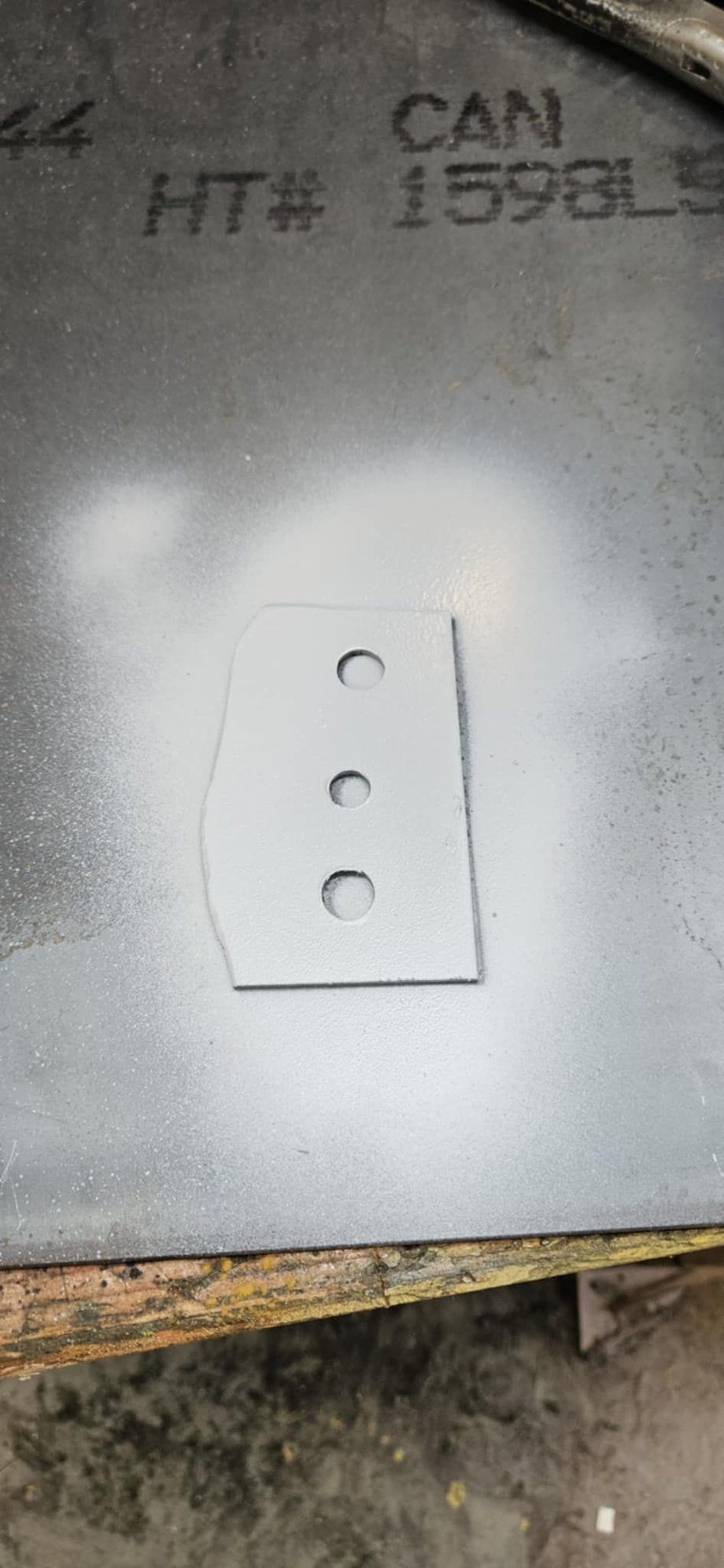

since this frame had suffered a failure... I decided to go belts-and-suspenders on it.. along with a new idler arm because the old one was in bad shape, and didn't have a castellated nut / cotter pin (turns out it had a lock nut). I put the arm back in with the botls and piece of tagboard to make a template for a 'fish plate'
this is the plate I created from 11ga steel (roughly 1/8") along with an extra hole for a plug weld. (That's weld-through primer)
we don't discuss my vertical-up welding abilities (or lack there of) but I gave that plate and frame hell to make sure it was re-inforced.
