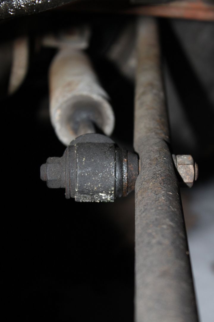

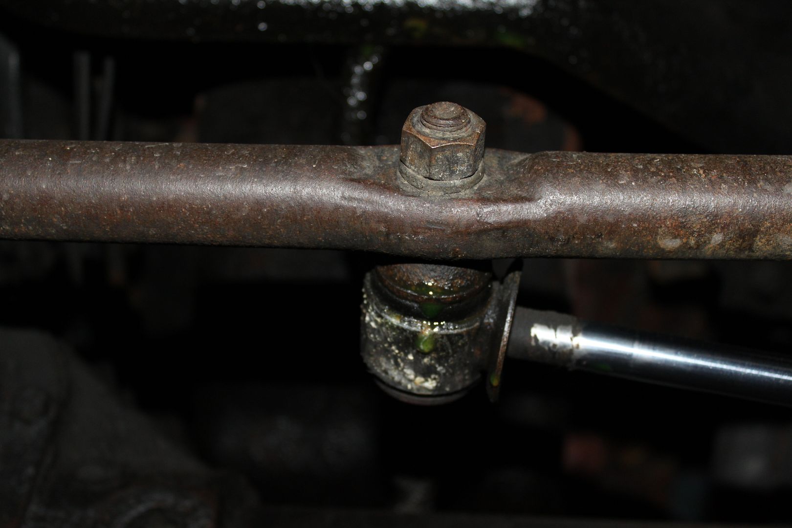

Here is what this area looks like on my '74:
Remove the nut on the opposite side of the shock (the nut on the left of the second image above) and the shock will slide right off.
If you remove the nut directly on the steering linkage (the one on the right), you will have to fight with the tapered press fit between the shock mounting stud and the steering linkage.
