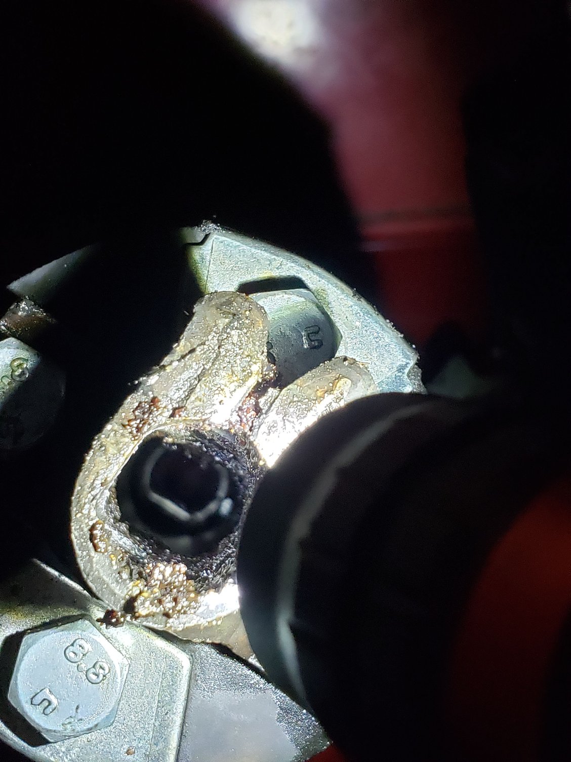

I know I've been posting a lot lately I've just got a question about this steering shaft. I pulled it off today and I noticed it was packed full of dirt like crud and I got a lot of it out. Here's what's left. What is that stuff? Is it old grease, and when I put it back on do I grease the inside of the shaft and not just the splines? I heard the flaming river u-joint is the easiest way to upgrade my type of shaft any opinions?

It looks like grease, but there's no reason to put any more than a very light coat of grease on the splines to make it easier to remove in the future.

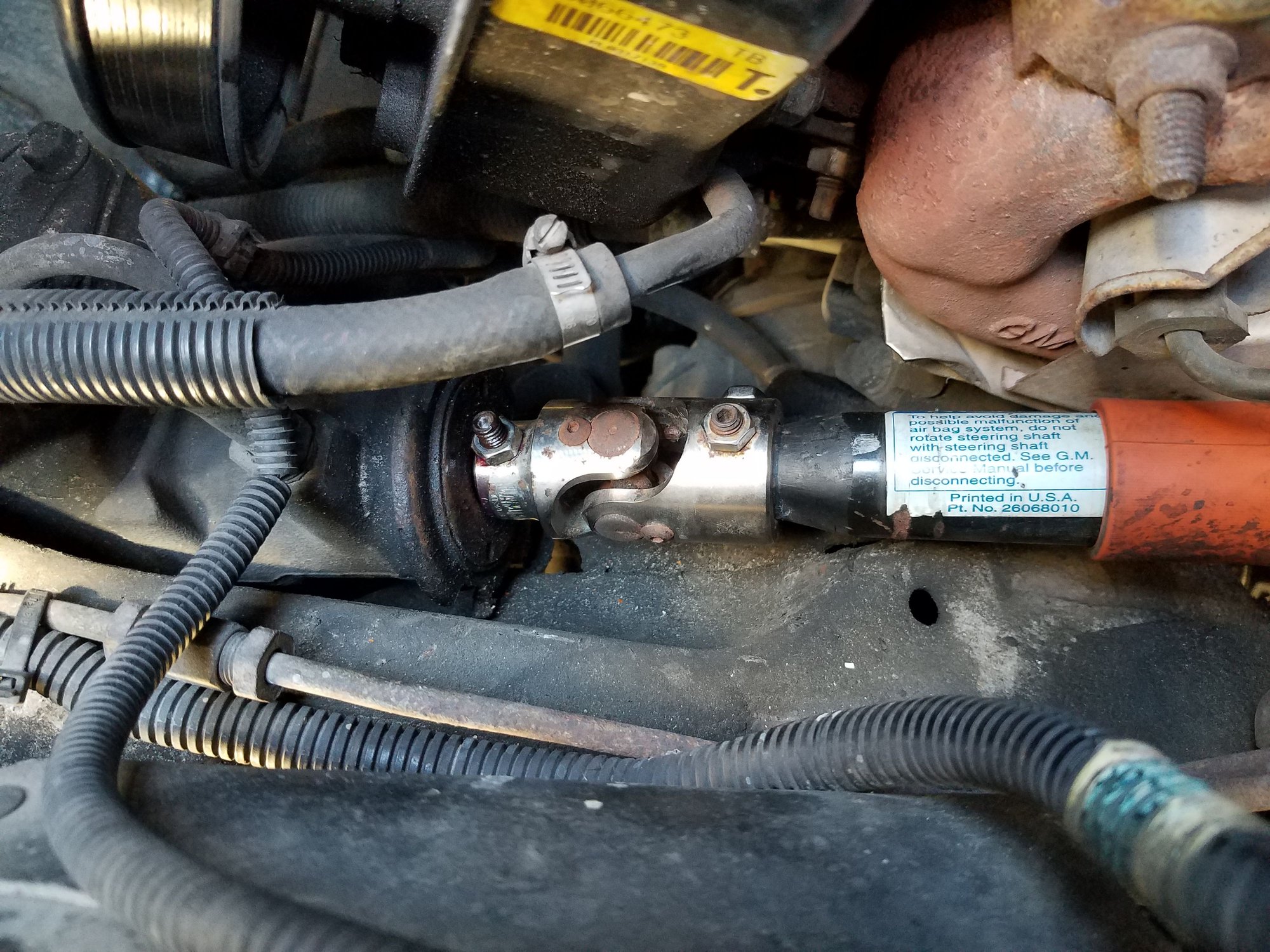

Eliminating the rag joint is a nice upgrade. There are a couple of different steering joints available, including the Flaming River. Mine is a Borgeson, for example. Personally, I would steer clear of cheap, no-name ebay stuff where safety is involved (like with steering). I think you can also use a Jeep XJ steering shaft with very minor mods, but it's easier to change the joint, IMO.
Old Jul 30, 2020 | 12:09 PM
I'd guess that the grease is from the steering shaft expansion joint that would allow for some movement between the body and the frame.

The Flaming River joint is awesome. I highly recommend
As soon as my rag joint dies 🤙
