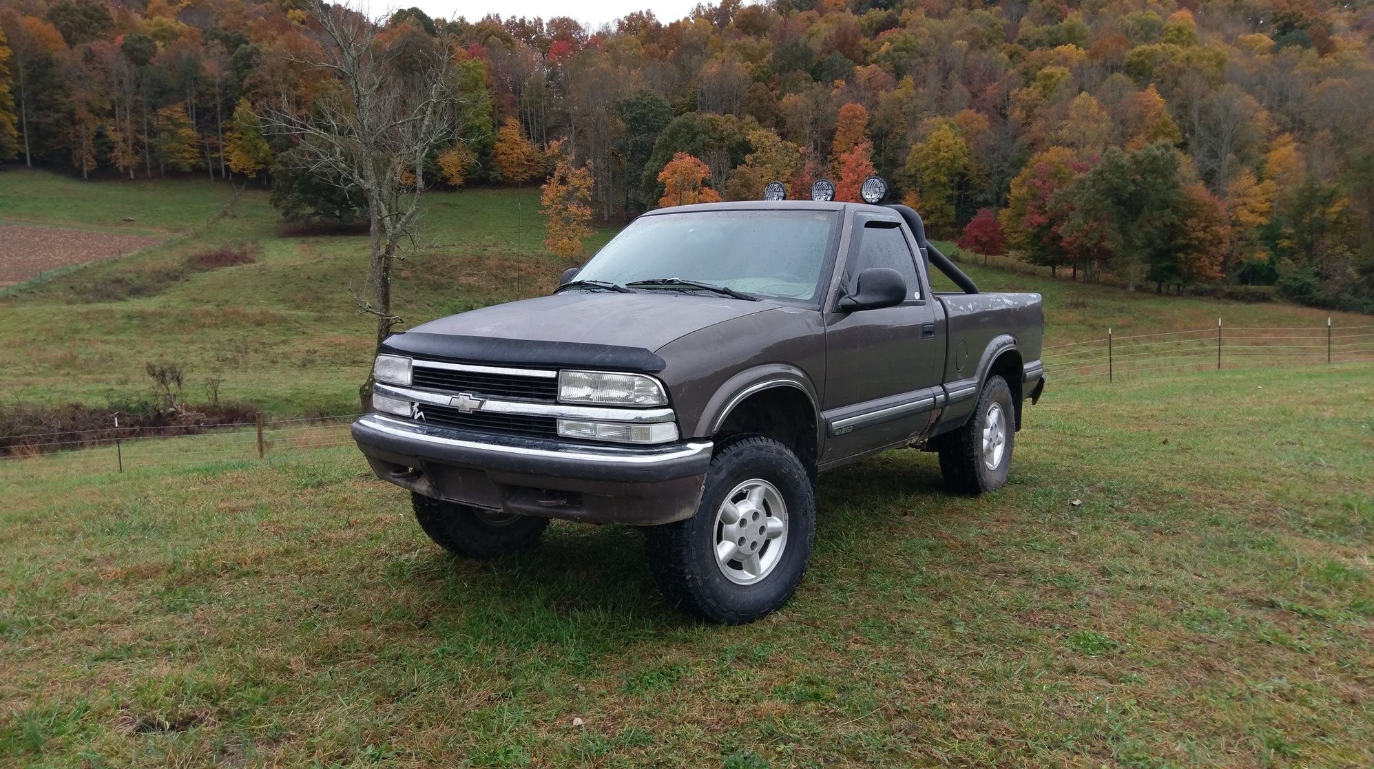

98 S10 4X4 with a rough country 2.5 lift.
Driven over a year with no issues (aside from the garbage shocks killing my back)
One day while riding through the woods, it starts popping, I take it home and have two broken front axles.
I immediately replace them both, only to have them break a mile down the road.
I tried different brands, auto zone, Oreillys etc. Each time they start grinding before I even leave the driveway. Sometimes they don't really break thru just seem to be pulled apart.
Is there a fix for this? Apart from completely removing the lift? I love my S10 I'm so aggravated with it to the point that I've just let it sit in the garage for months. I hate to do it and really miss it but I can't get any help from rough country or local mechanics.
Any advice?
