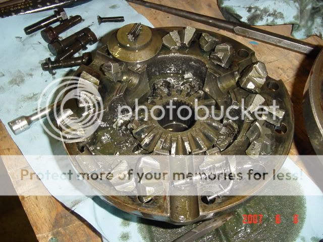

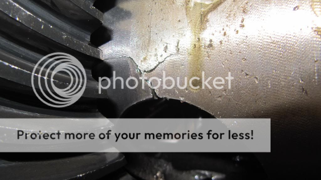

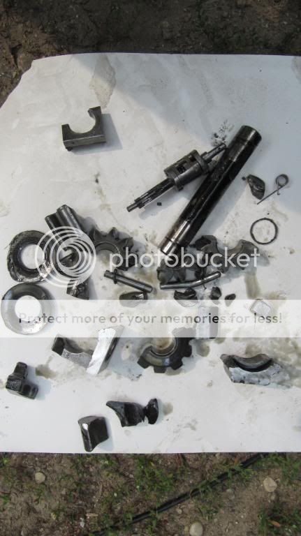

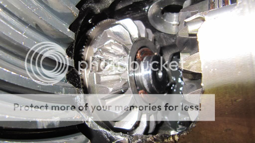

With the rear cover off, you should see something along these lines:
Obviously if you see this kind of stuff:
or
it's gonna be bad...
Besides obviously mashed up bits, look for stress fractures
and things that "dont look right" as far as how the part is shaped or sitting
oh, and if teeth fell out thats bad too
