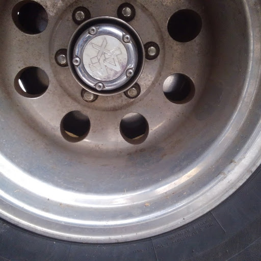

Had this Blazer about 9 months now and never needed to put it into 4 wheel drive until now. I put the truck in neutral and put the lever in 4H then I put it into drive and the front wheels wont spin.
I assumed it had auto locking hubs because there is nothing to turn at the wheels, (see photo).

Those are auto locking hubs and they are likely frozen up. I would recommend replacing them with a set of selectable lockout hubs like the
Warn 20990 Warn 20990
The actuator you purchased is for the NBS trucks with the independent front suspension setup, not the older squares with the solid front axle.

If the hubs are automatic, what determines this? Is there a sensor or some thing?

Its like a one way clutch , when you engage the 4x4 lever the trucks forward movement locks the hubs , when you select 2wd you often have to back up to unlock the front hubs.
