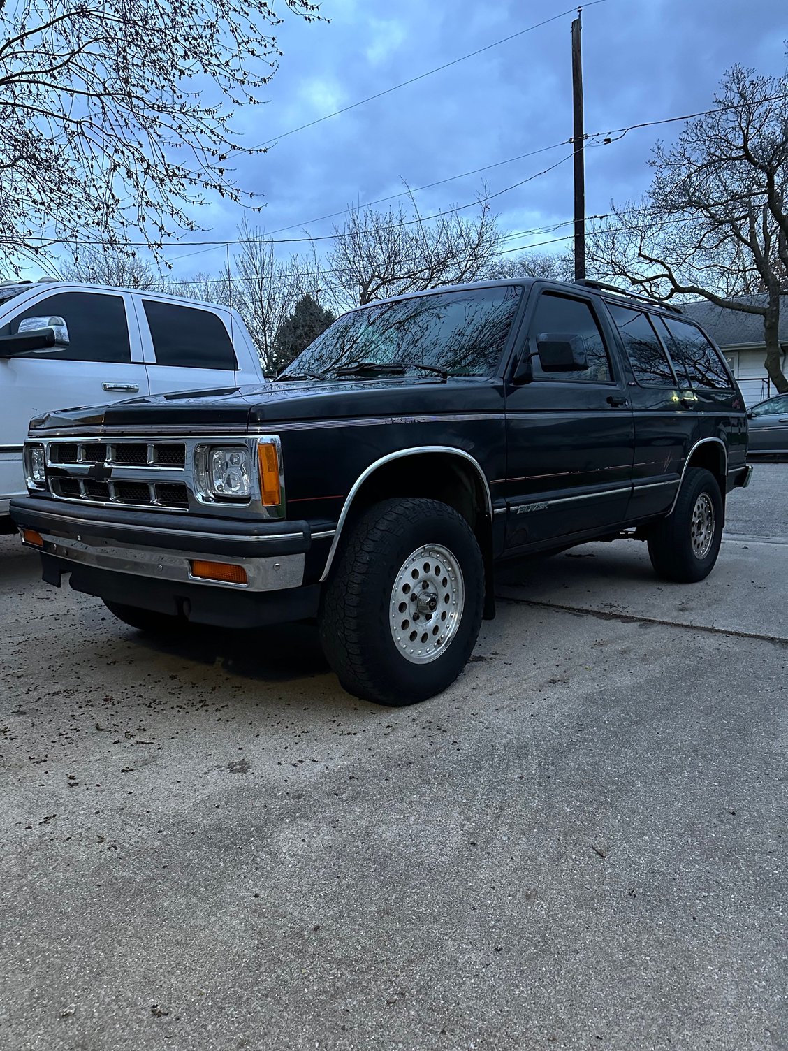

Picture included of my new to me, $500 blazer
