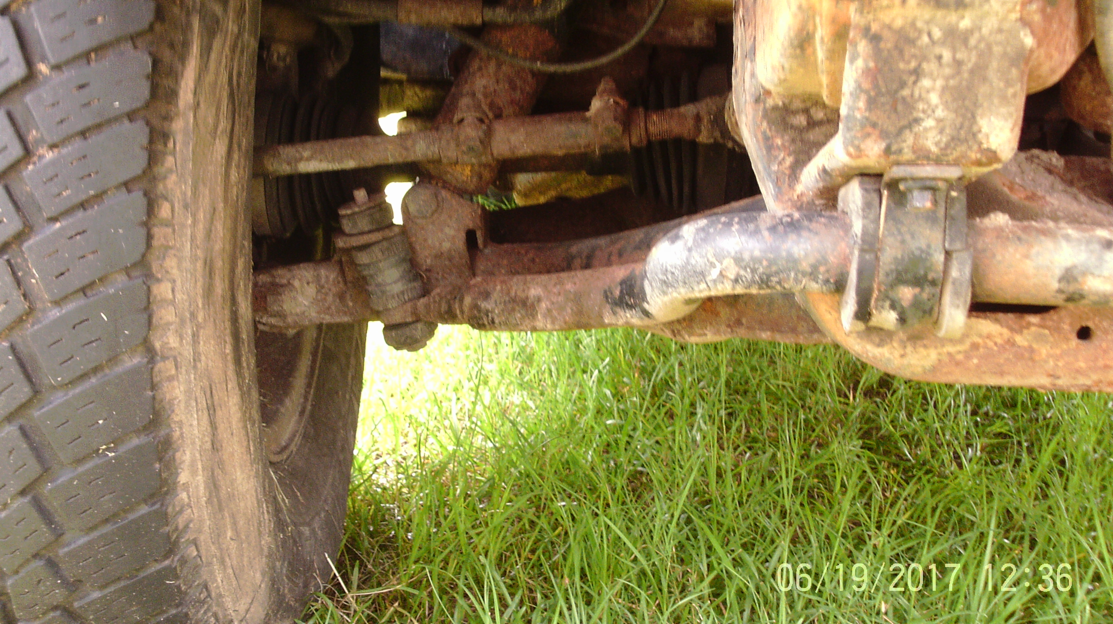

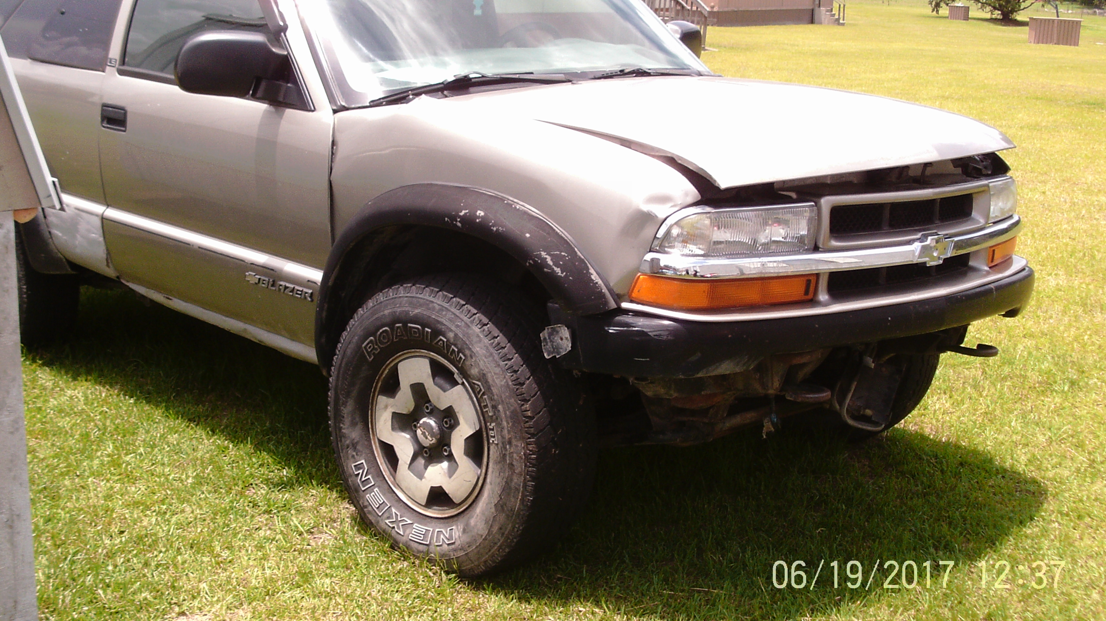

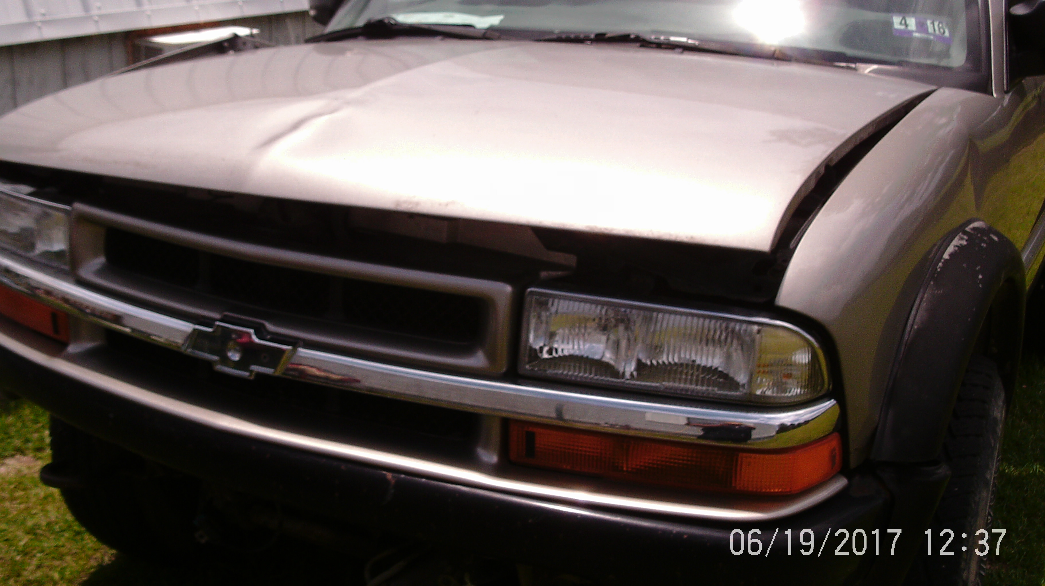

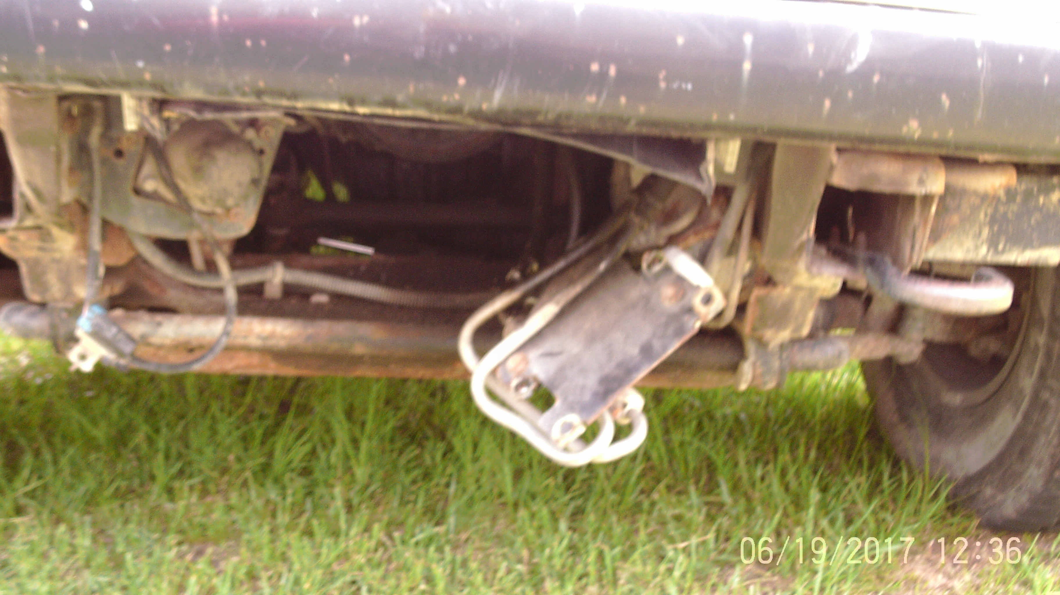

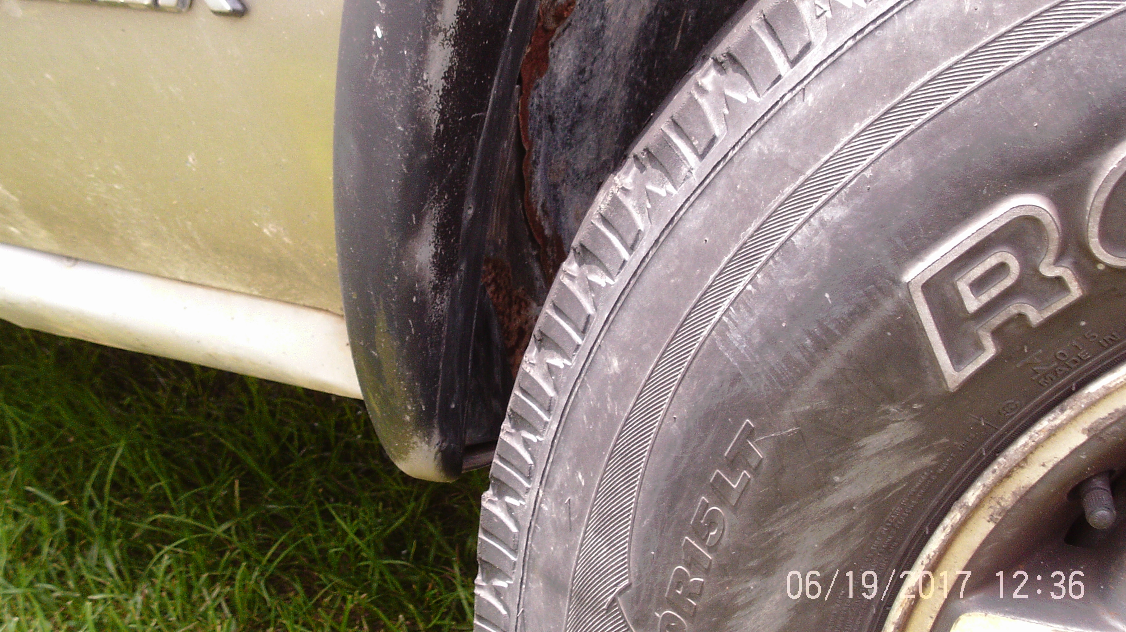

Hi all,
I have a 2000 ZR2 4x4 my wife wrecked. She drove through a five foot ditch and jumped out the other side.
The vehicle runs good still and the trans is fine. Standing facing the engine, the left wheel is pushed back to nearly touching the wheel well.
I do my own automotive repairs, but this is beyond my meager experience. I took pics and can post as many as needed.
Attached Thumbnails Fix, scrap, or turn into 5k pound go-cart?-ptdc0006.jpg   Fix, scrap, or turn into 5k pound go-cart?-ptdc0007.jpg   Fix, scrap, or turn into 5k pound go-cart?-ptdc0008.jpg   Fix, scrap, or turn into 5k pound go-cart?-ptdc0009.jpg   Fix, scrap, or turn into 5k pound go-cart?-ptdc0010.jpg

throw all that front suspension garbage away and slap some leaf springs along with a straight axle and enjoy. i bought my 93 as it was hit in the front and kinda messed up, perfect to bounce off trees with
