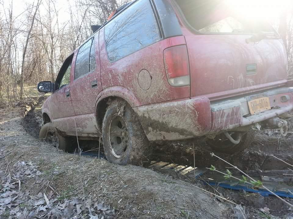

They don't sell them, I've made a set before though. I made them for the front links with some channeling welded to one side of the links(so it slipped over the sway bar and didn't spin as I tightened it) and used wingnuts instead of the regular nut on the other side, with a cotterpin thru a hole i drilled so they couldnt back off when they were in.
I also welded the center spaced to the 2 bushing washers, and glued the other 2 bushing washers to the bushings. This made it less parts to keep track of, and much quicker/easier to connect/disconnect on the trail.
Then I had a little u bolt that was originally used for the rear sway bar(I removed that one completely) that i used to attach the swaybar to a hole in the bottom of my bumper(no balance, direct to the chrome bumper) to keep the sway bar from flapping around under the front end while disconnected.
Between removal of the rear bar, and front one discoed , the added flex honestly amazed me.
Here's a couple pics for reference
Don't have a great pic of the rear, but it would tuck 90% of the rubber in the wheelwell fully flexed
