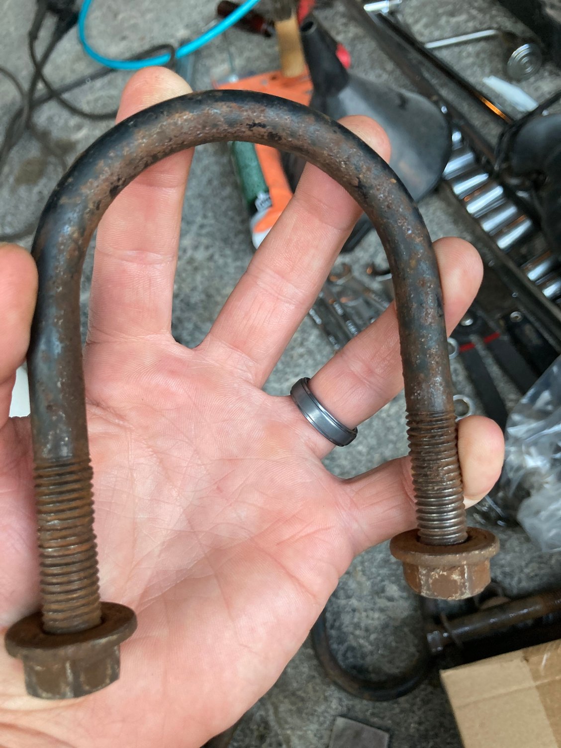

Hello.
I’m in the process of rebuilding a 2002 Blazer LS 4WD and I’m starting back to front. I’ve cleaned up all the rust and painted, I just can’t seem to find the u-bolts and bushings anywhere for the rear sway bar. I wanted to replace them while I was there. I was able to rock auto the sway bar links without an issue.
does anyone know what size or part numbers they are?
Old Aug 21, 2025 | 10:08 PM
I believe this is it, #9 on this page:
https://nemigaparts.com/cat_spares/e...t/07/ts07-563/
M12 x 1.75 x 105, 40 (u bolt) 15152683
You can double check the part number at a GM parts retailer online.

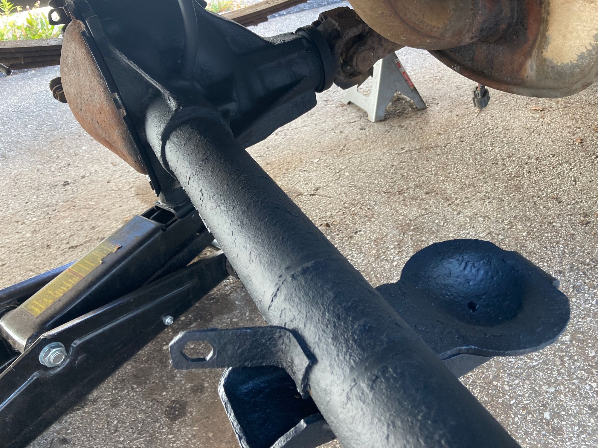

been cleaning up this bad boy.
