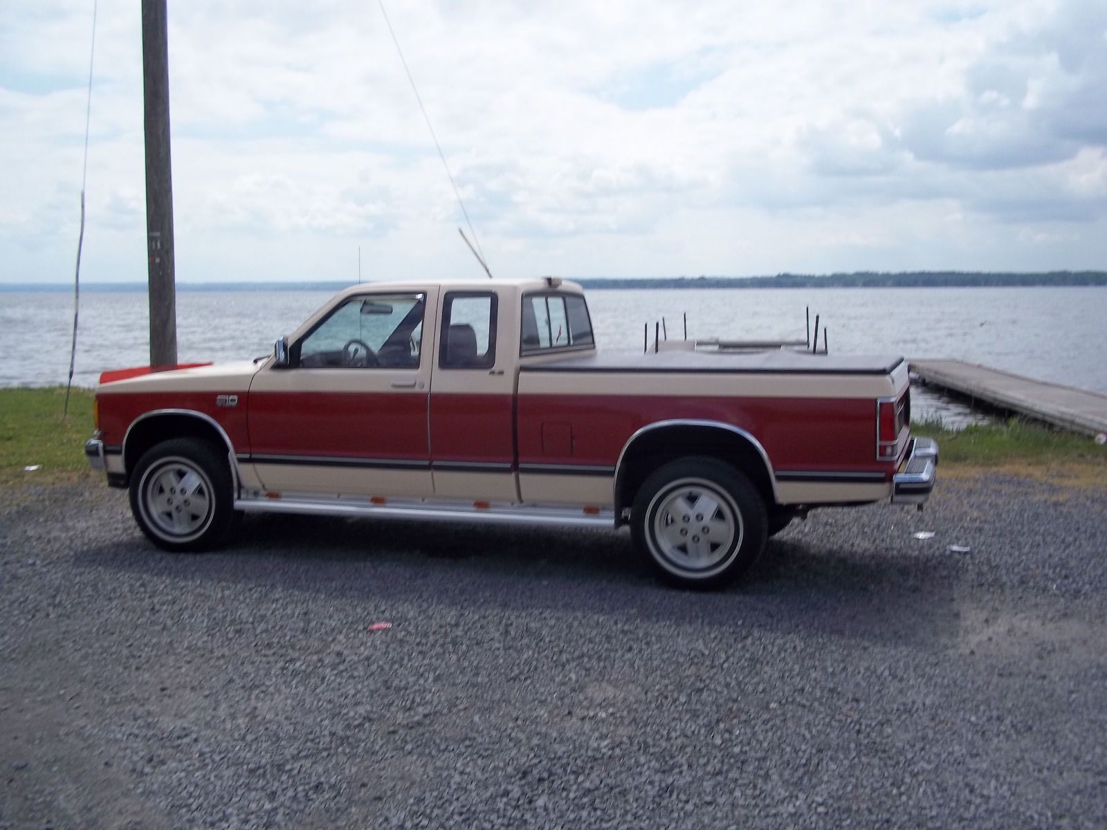

This is the 1988 S10 Tahoe 4x4 pickup in beige/red 2-tone.

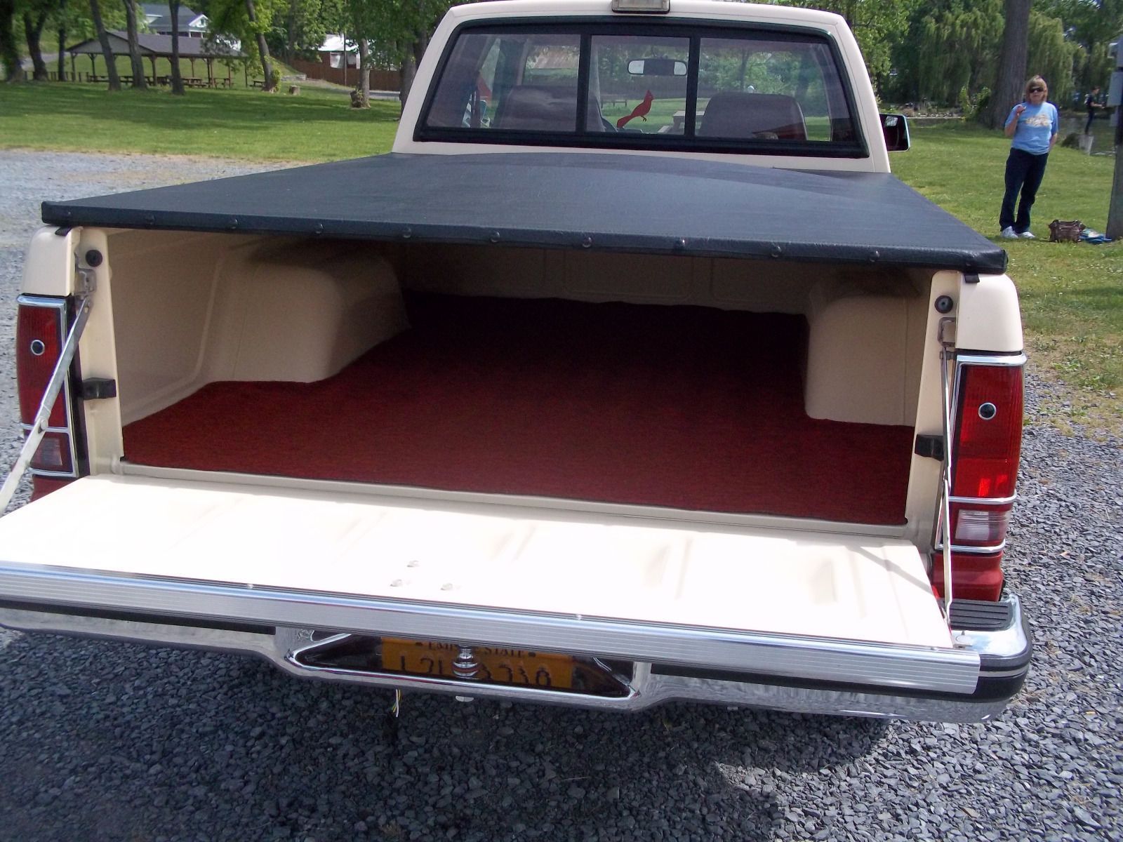

Not one single scratch on the tailgate or bed. The bed has been covered by this red rug since new.
