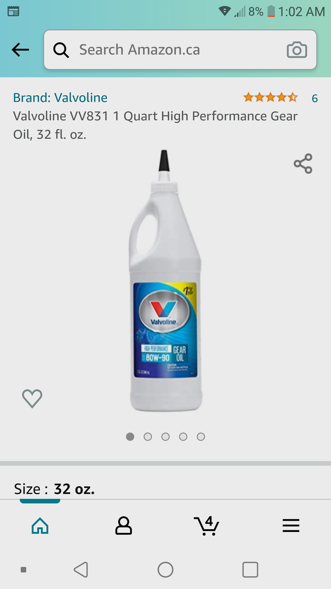

Old Jun 4, 2021 | 12:07 AM
CODEE_'s Avatar
Joined: May 2021
Posts: 52
CODEE_ is on a distinguished road
Not familiar with that brand. I use Valvoline regular 80W90 gear oil
this stuff ?

Old Jun 4, 2021 | 11:58 AM
I just now looked at my records. Here is what I have been using:
Valvoline 80W-90 gear oil; p/n: 773732 (old p/n: VV832)
rear cap. = 4.0 pts
front cap. = 2.6 pts
Edit:
FYI: As for part numbers: the 773732 is for when it comes in the gallon container and VV831 is for when it comes in the quart container.
https://www.valvoline.com/our-produc...mance-gear-oil
