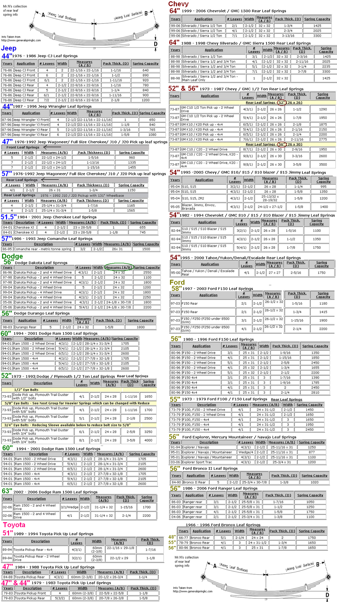

OK, I recently purchased a 2003 Blazer ZR2 and it has the usual rear spring sag. I've searched high and low on the the forum but cant find an answer to the question of spring difference between the regular Blazer and the ZR2.. The specs (dimensions) seem to be the same, according to the diagrams on General springs website. Are they interchangeable? If so, will the increased weight capacity (1300lb vs 1100) equal an increase in height?

Here you go

Thanks, but I only see an S10 ZR2, and no Blazer ZR2.

Oops, I thought it had blazer zr2 on there too. Sorry!

I've seen what my ZR2 springs look like with the reverse dutch thing, but all of the springs on this website look the same, the only difference is the # of leafs in the pack. Is there a different arch height between the two? Are the shackle bolts the same diameter?
