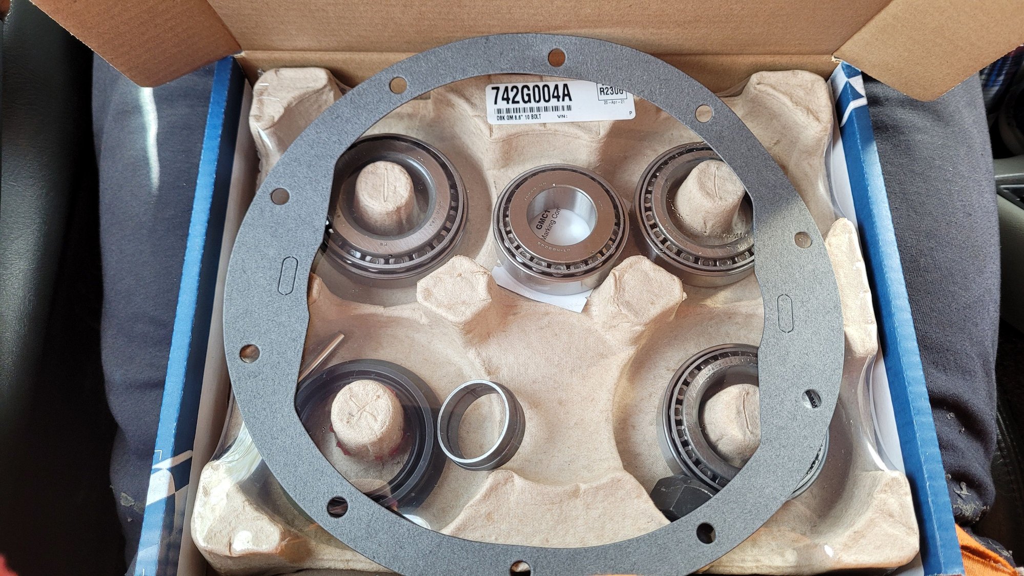

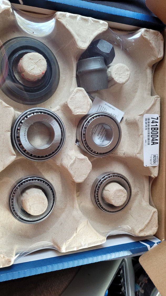

Picked these up for the mechanic, gave him a boot in the butt last week to get on my axles. Supposed to rebuild over the next few days, we will see.
Rebuild kit for ifs
Rebuild for rear

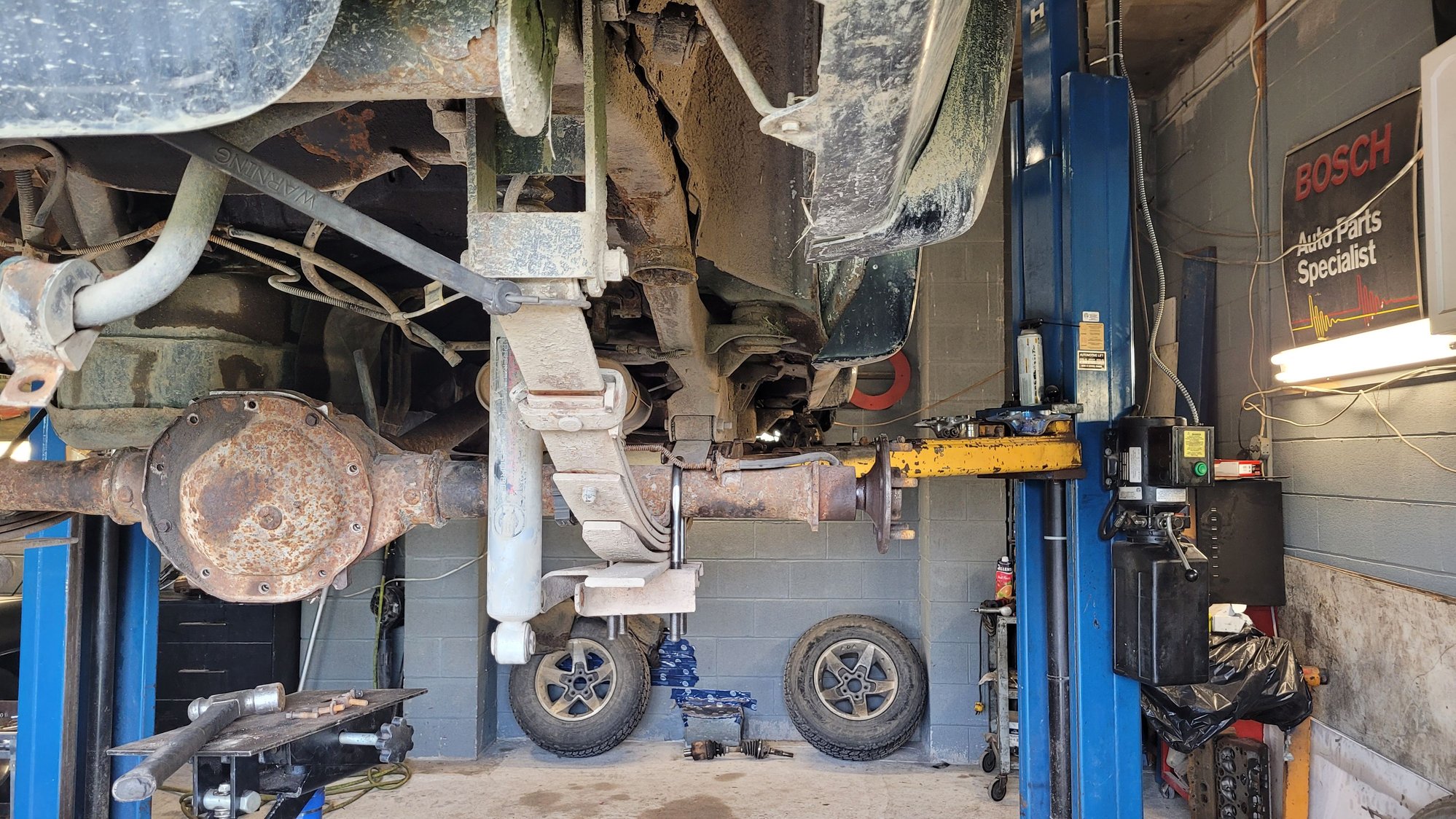

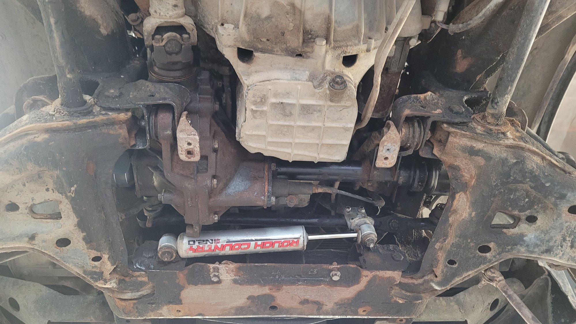

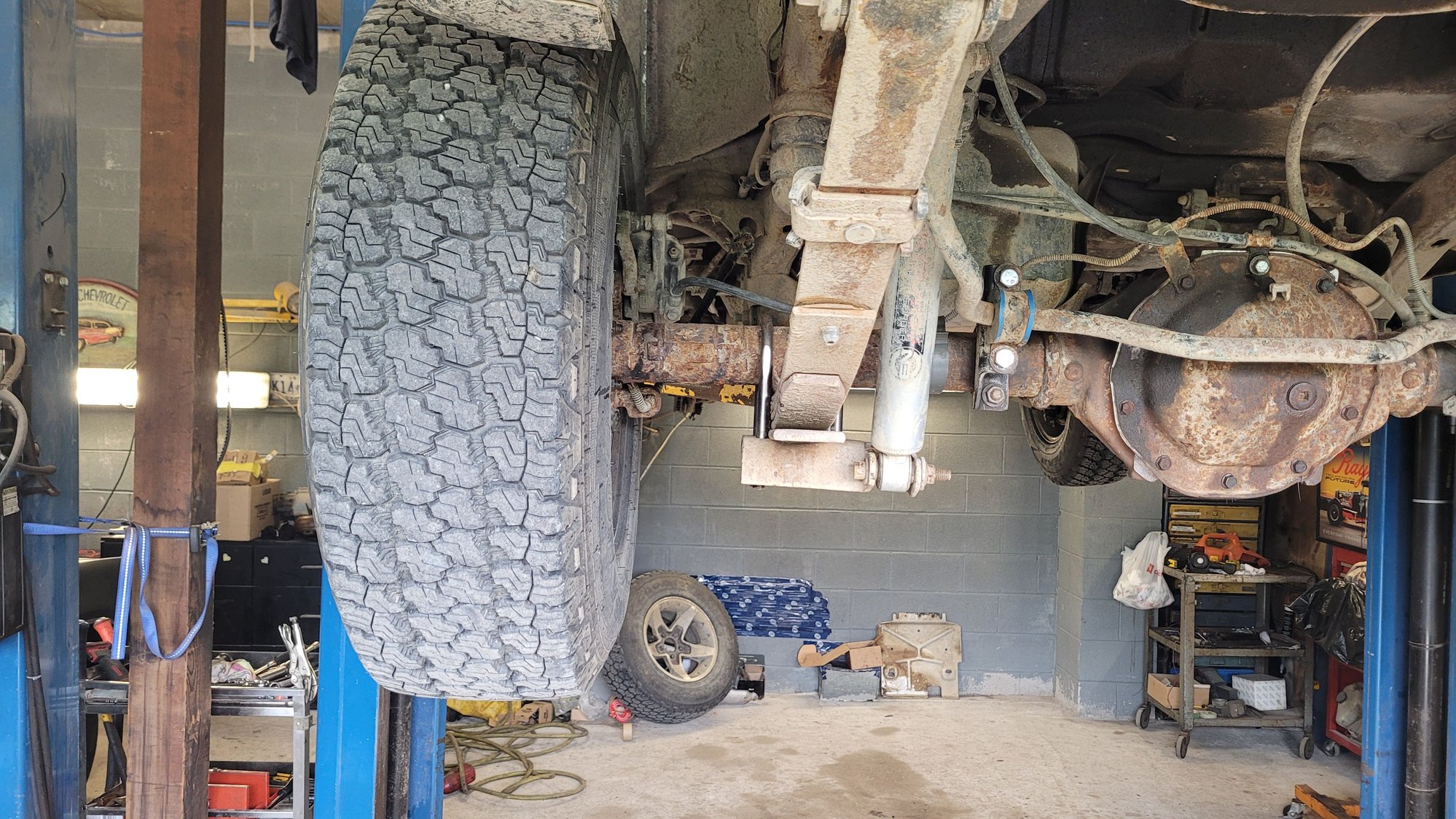

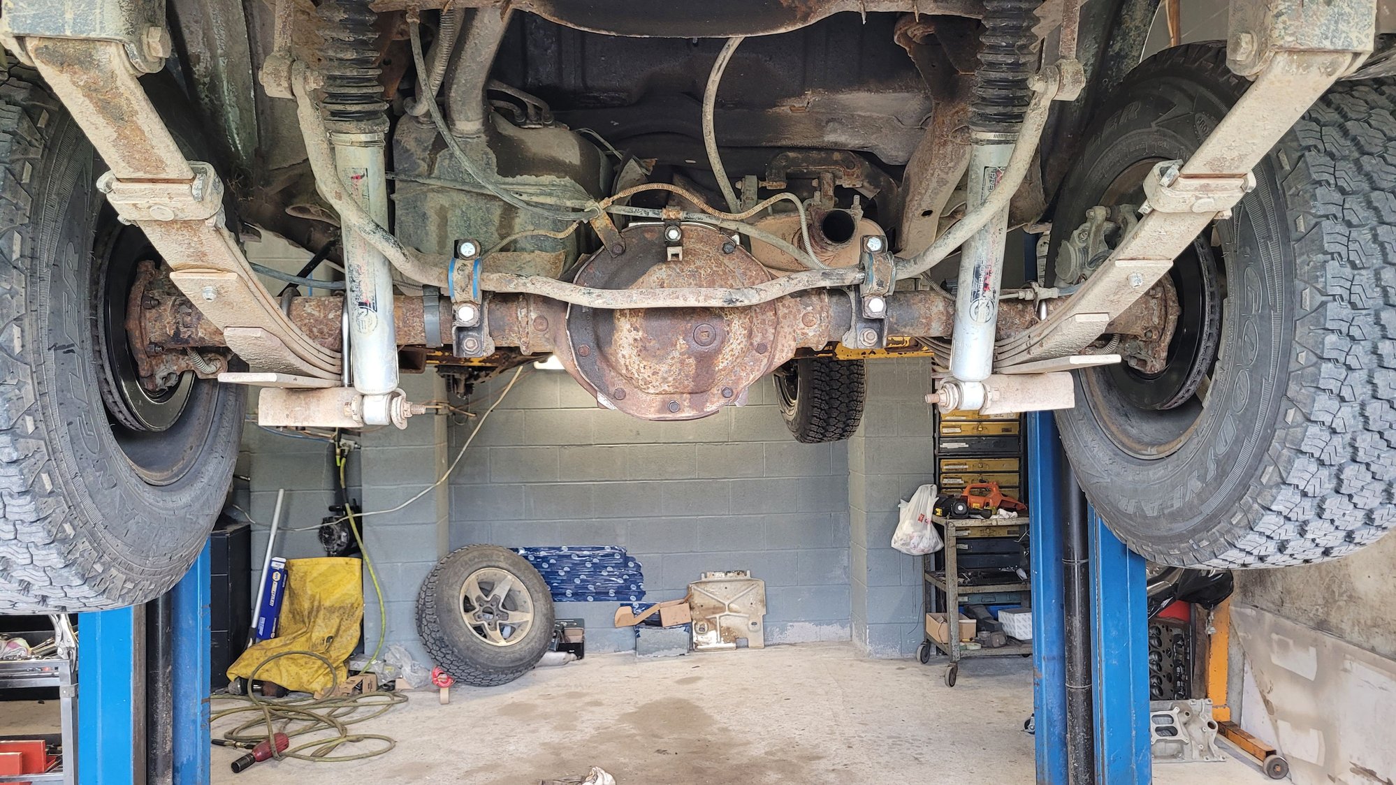

Couple of small things to finish bolting it in, but everything is under the truck!
So the front diff is in, no alterations needed.
Rear axle is in with the yoke that came with the axle, it fixed the fact that the shaft was moved when the lift was installed.
No modifications were needed for the axle to go in!

Front cast iron diff from zr2
Rear zr2 axle. Showing new wheel position.

So I didn't have to swap anything for the axle and diff to go in...
Having the lift, I do have to do the following:
- Install diff drop bracket, diff didn't dropped enough for the angle of the cv axles and they bind
- replace ebrake cable on drivers side. Cable gets snug when axle is flexed. Could be caused by the add a leaf with the extra 2" on the lift
I would double check with how much play you have, the yoke on the read diff is extended a little. A non lifted blazer would need to have a non balanced yoke, or the original one they had.
So much room! And no spacers!!!!!
Oh and the gears are well worth it too!!!!!
