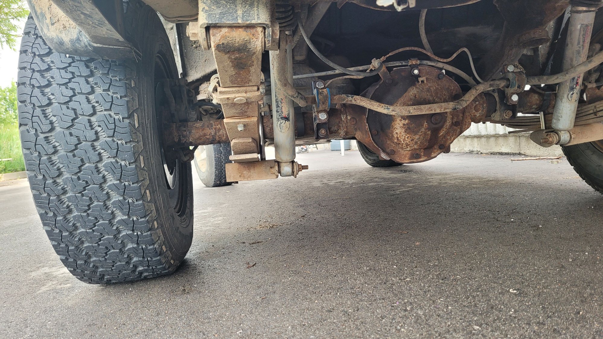

Comparison ov 4x4 axle, and zr2 axle. Both have 2wd rims.

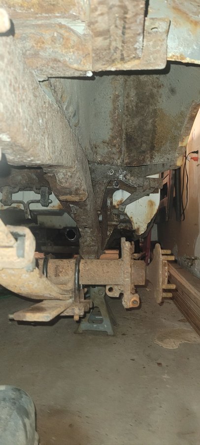

Well looks like the 4x4 axle will be going under after all lmao...
Won't be functional other then rolling, but it'll give an idea of space and parts needed... so I'll slap a pic or two when it's on!

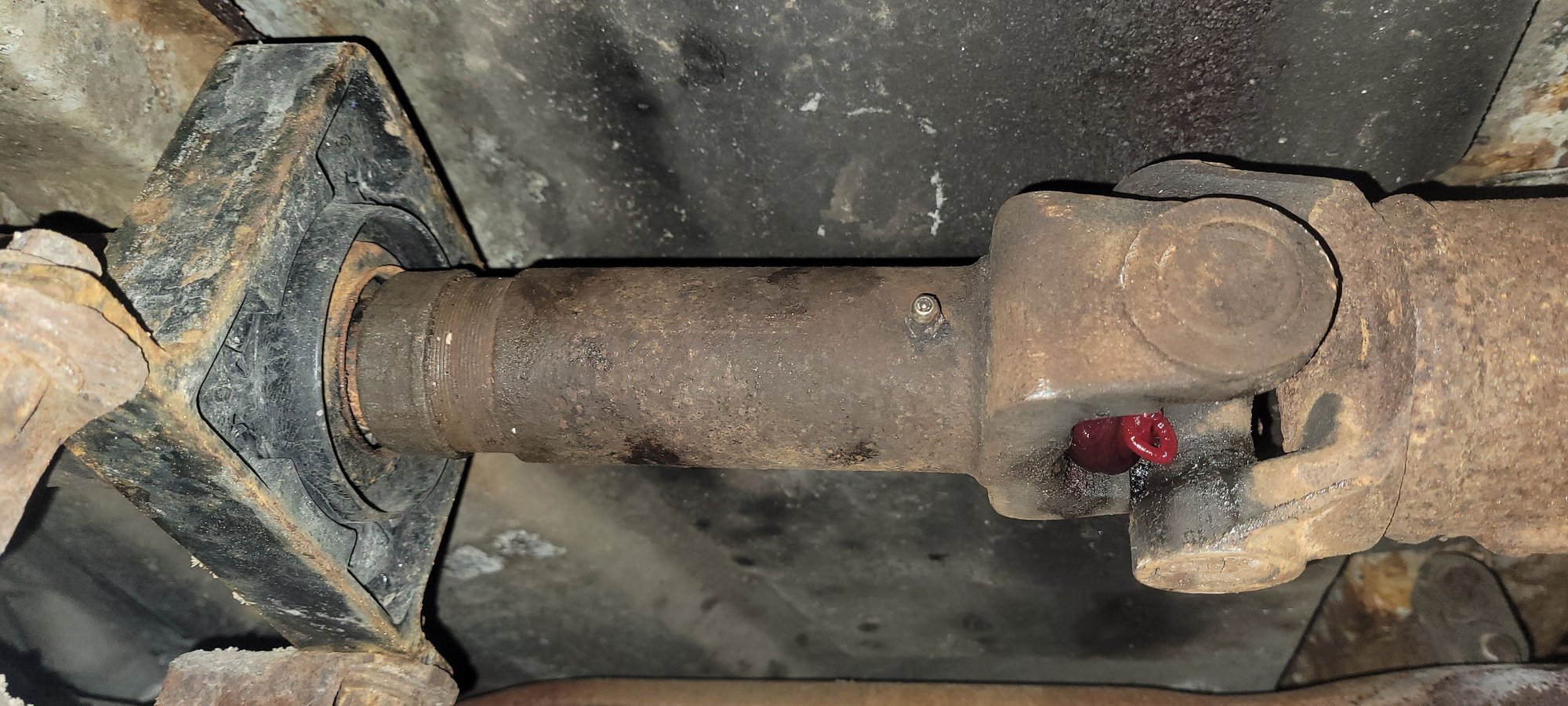

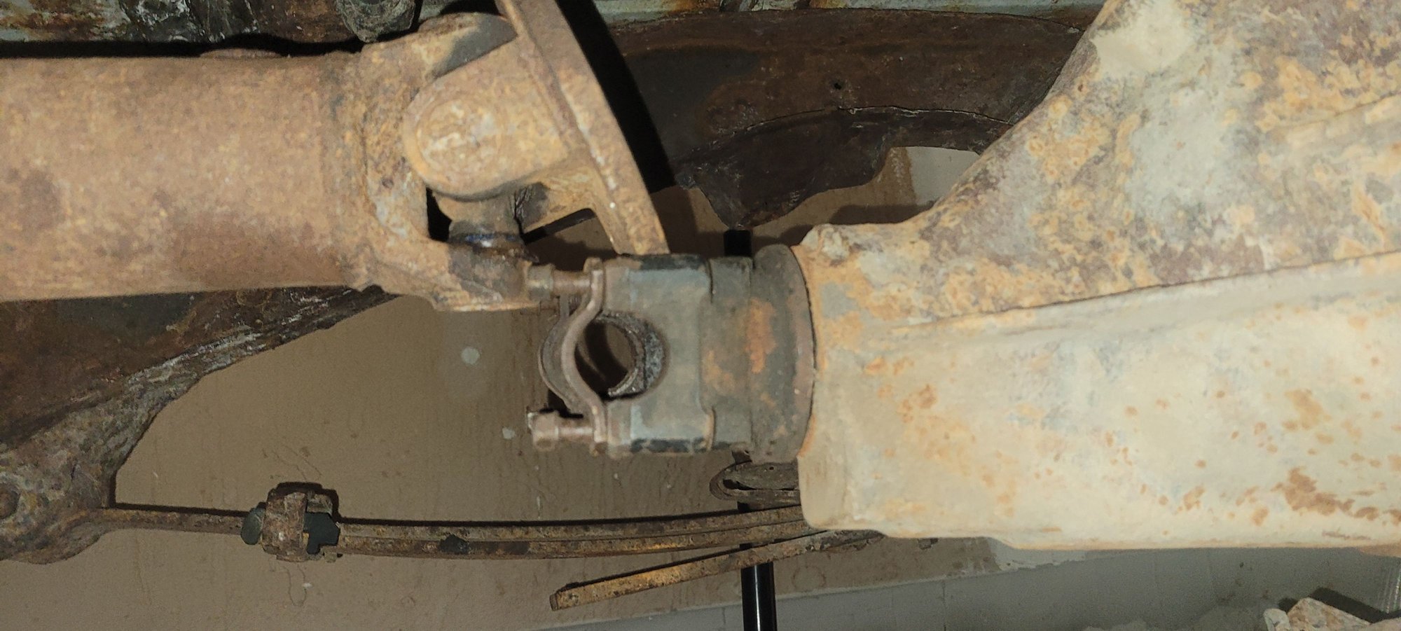

Passenger side
Front yoke pushed all the way in
How much room you have to play with a stock 2wd shaft

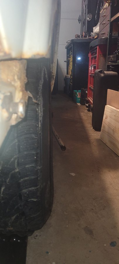

  #30
This wouldve been a very SEXY stance... a lil heart broken i couldnt keep this one on the road. But will DEFINITELY do this if i get another one in the future!!
So this is what I can see:
Hop shock braket will be lost, or you will need to weld it on.
Fenders will have to be modified, inner lip will have to be fully removed, and maybe trimmed with a flare to cover the work. Can use 4wd rims to cancel the work needed for this.
Driver side ebrake line "SHOULD" be good, but the one going to passenger side will have to be extended, or purchase the 4x4 one.
your choice if you want to remove the bump stops from 4x4 axle housing. 2wd uses triangular shaped ones, 4wd uses round ones.
Brake line will have to be extended, or use 4x4 ones.
THIS IS ALL ON STANDS, I HAVE NOT DRIVEN IT, AND WONT. WORK WAS DONE JUST TO GET THE TRUCK TO SCRAP METAL YARD.
this being said, it's work that is expected, and not sure if much is needed beyond this. But to what I can see and tell, this is all that should be needed.
HOPE THIS HELPS!!
