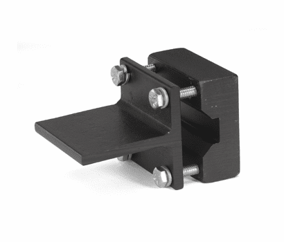

I've seen tools that clamp around the torsion bars to provide someting to hit with a hammer. Would one of these be useful?

BTW the tool in the picture is one the Mopar people use. It clamps around the torsion bar providing a suface to hit with a hammer to help slide the t-bar back. I first saw pictures of these in the manual for the 71 Dodge Dart I had in college.

I may need to look into that tool if/when I need to change out bushings on the LCA. They use magnesium chloride on the highways out here, but not on the back roads. Only get on the hwy when we need to go down to Colo. Springs.
