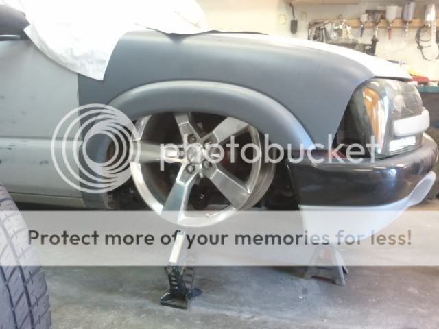

Ideally, since yours is a 4wd, you would need to either go with 4 front wheels or 4 back wheels.
But they will be very hard to pull off because of the backspacing and the size of the wheels.
Keep in mind this picture has the s10 jacked up and the full weight of the vehicle isn't on the tires. Also, this truck has no spacers and is not lowered. These wheels are not bolted on, he just put them on the truck to see how they would fit.
Good luck to you sir if you try to put these 'Maro wheels on, but it looks like A LOT more trouble than it is worth.

I found this thread the other night but it looks like the updated it. It looks pretty sweet! so all I would really need would be just the wheel adapters to go from 5x4.75 to 5x120? With a 9" wide tire and a 4x4 am I going to run into any clearance issues with back spacing in the front or rear?
