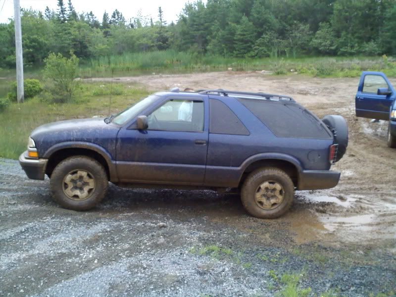

Originally Posted by swartlkk View Post
Sure looks higher than stock to me...
I was thinking the same thing Kyle...I'm running 30's, and mine look closer then those...
An old pic (same tires tho):
Mine:
Yours:
And the other one:
vs

An easy way to see if anything was screwed with would be to measure the length of your shackles. if someone threw a lift on there, good chance shackles were added (not 100% though...). search for the thread requesting the shackle demensions from last week. compare yours to that. one quick way to check...
you might also want to compare the height from center of your wheel to the lip of your fender. if there is lift there, it could be a cranked-to-the-max torsion bar and worth checking out since you will soon know that you are stressing out your front end (unknown to you) when your front suspension goes belly up by way of spent components...

I'm not saying it's not stock height lol....it could very well be. I'm just skeptical since all other evidence I've seen on the site points to the fact that 31's won't sit on stock height...let along 31x10.5's. Those are BIG tires to be jamming on a stock heigh ride lol.

i'm gonna go ahead and say it doesn't look stock height and I do not believe it to be stock height. not saying he's lying or anything stupid like that, just saying by all accounts, you would have "only some rubbing" after a lift with the 31x10.5's. everyone else gets "major rubbing" if they go less than 3" up from what i have read.
