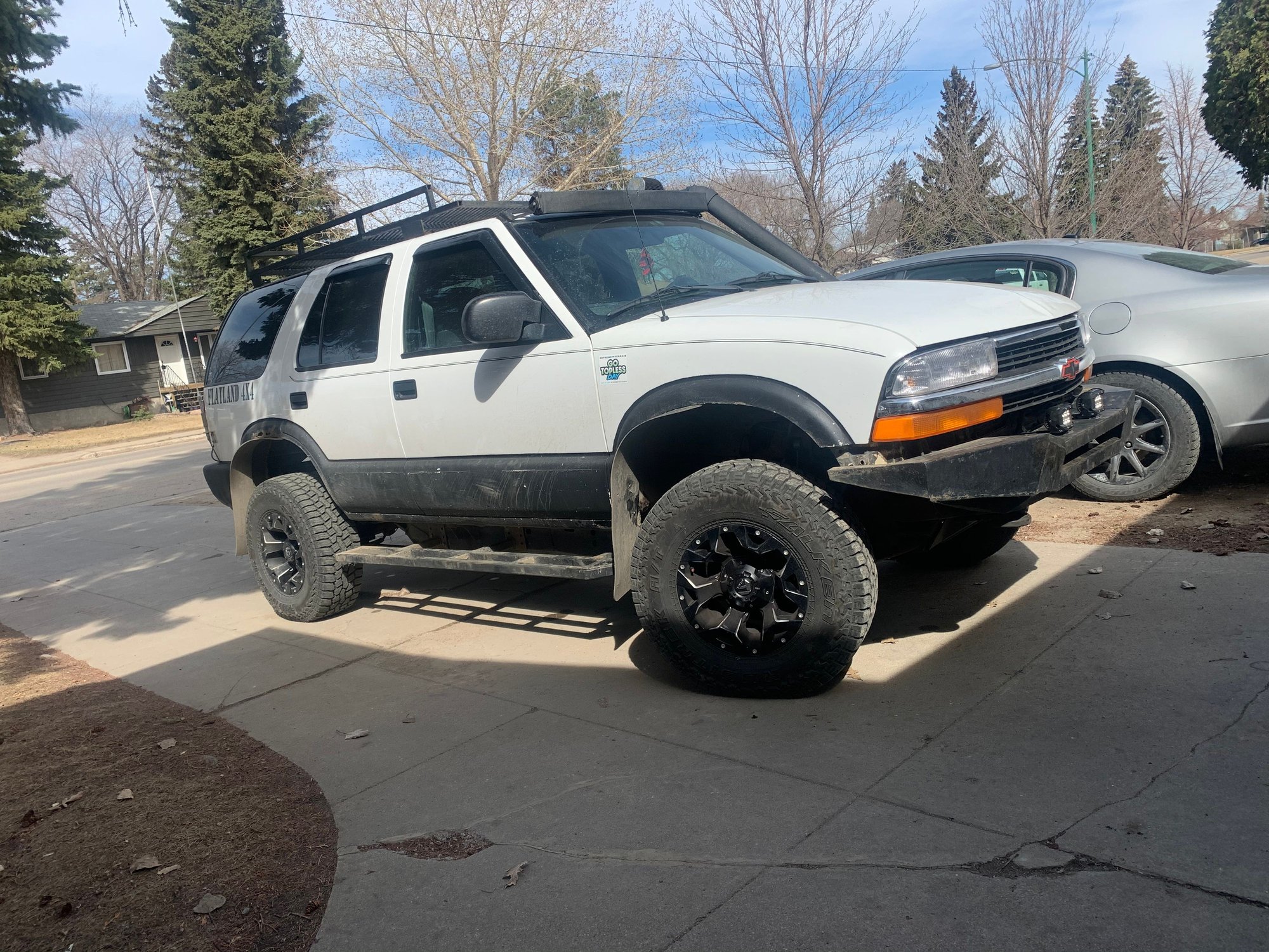

well I already have the rubbers i just want to get an aftermarket rim I want a deeper dish but my options for offset on the rims I’m looking at are -6 -19 or -43 I’m just stuck between -6 and -19. I’m thinking with -6 it will just stick out maybe 1”? And -19 would be just over 2” and then get some flares also I don’t want tire rub
Old 05-04-2020, 01:05 AM
Join Date: Mar 2017
Location: saskatoon, SK
Posts: 385
Took 3 years to get to this point but these rims are 15x8 with a -19 offset I am running a 2.5” rough country suspension lift and this pic was right after I pulled out of the garage after installing a 2” pa body lift I love the tires and look with how much they stick out
