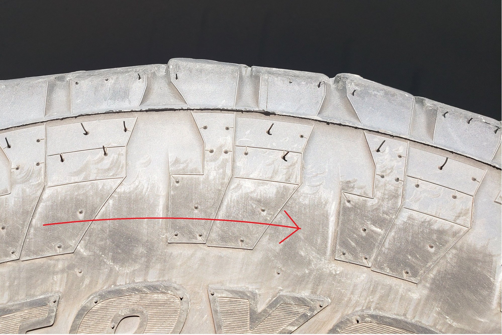

First some pictures of the tire wear on the rear tires. There was no odd wear on the front.
This is the right-rear tire. I added the arrow to remind myself of the direction of rotation. This pattern is called heel-toe wear.
This is the left-rear showing the same heel-toe wear as on the left. Neither of the front tires showed this pattern.

This type or wear is called heel-toe wear. It is associated with not rotating ones tires properly or frequently enough.
There are lots of descriptions of this type of wear on tires but few if any include the direction of rotation on the picture so you can be sure of their description. (A picture is worth a thousand words, right?)

What confuses me is that according to these pictures, my tire wear is in the wrong direction for tires rotating in the directions they would due to their current location. Further more, looking at my last alignment from December of last year, the total toe-in value was 0.06 degrees which was designated as fine. The Left and Right toe-in values were -0.06 and +0.12 degrees respectively.
A preliminary inspection showed me that this heel-toe wear is only on the outside edge of the tires. However, I want to double check that.
I do have an issue that I think might contribute, but I'm not sure. It is that I have Rough Country upper control arms, that are longer than stock and are intended for Blazers with a small lift. However, my torsion bars and rear springs have sagged so that even with the t-bars cranked and longer shackles in the back, the truck is close to stock height.
I also intend, but forgot to call the tire store and have them confirm when I last had the tires rotated. According to my notes it was about 3,000 miles ago. [EDIT: I was able to confirm that the last time the tires were rotated was about 3,000 miles ago back in November.]
Combining the descriptions above with the pictures, the wear pattern and direction would make sense if they had been rotated recently. If they had been on the opposite front corners, the direction of rotation would have been correct for the direction of the wear pattern, and that if on the front, that would be consistent with the comment above that it is more likely to occur on non-driven wheels. [EDIT: I now suspect that the tires must have had this wear pattern before they were rotated from the opposite front corners. I think I will be having them rotated again very soon, but this time moving the rears directly forward and the fronts to the opposite rear corners which is what GM recommends instead of how the tire shop does it which is only on an X pattern.]
From what the tire store person told me and what I read, the remedy is to run them and let them wear back to have more even wear.

As you can tell, Im not on here on a regular basis... Anyway, I think you already figured out why they are acting up at highway speed, the heel-toe wear actually bouncing the wheel up due to the backwards ramp effect. Curious if it's still as bad or if you swapped sides just to keep your teeth from rattling loose. Another thing I realized is thst there hasn't really been ANY tire reviews for about 15 years! Its still the same ones I looked at 10 years ago when I put my Hankook H727 on. They still have treadlife somehow but after picking up something 2 days after getting it licensed and back on the road, realized that no shop is going to touch them. New tire plugs are in the mail because I too dont want to put another set on just yet.
