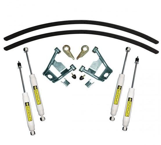

Old Jan 16, 2019 | 01:58 PM
Originally Posted by nomoresubies
Not sure of the brand of a arm. Was told it was a "superlift" lift kit with tubular a arms. 16" rims and new tires will be for the next go around. Spacers are the budget for now... I can get about 1/2 turn out of the steering wheel right now w/o rubbing.
This is the lift kit that was made by Super Lift that I think they no longer make. If you upper control arms look like these, then they are super lift ones. At the time, I never considered that the RC ones would have less interference with the rims than the SL ones.
Old Jan 16, 2019 | 02:06 PM
