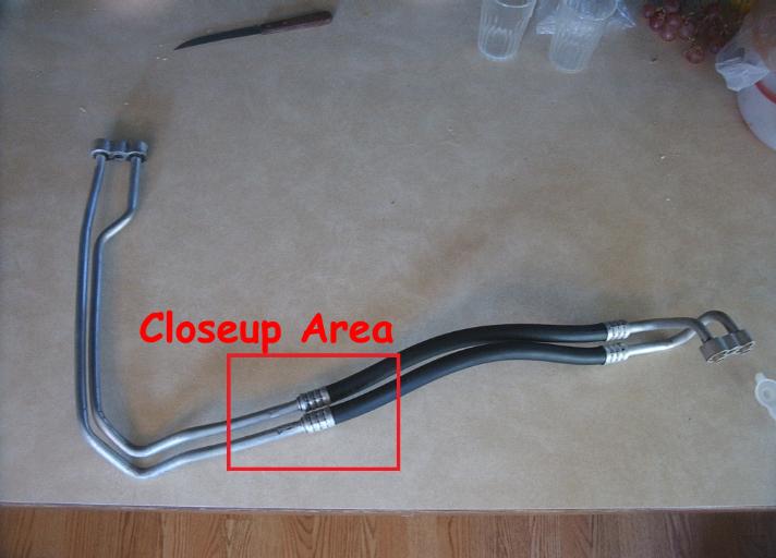

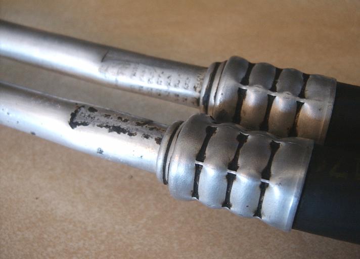

Why I replaced instead of repaired my oil filter lines. See photo. I considered the cheaper repair job, until I removed that bracket from the PS pump.

The lines came out from the top, not the bottom as I thought. It doesn't look possible but there is enough room to pull them out. Actually I laid underneath and pushed them up while pulling the tubes forward. They came out in a big "C", a half circle. Once the lines are moved forward a few inches, the rear end of the lines will drop down and the lines will swivel up and out. After the 'end' was past the eng mount, I crawled out from underneath and easily pulled them out leaning over the front fender. That PS return hose would have definitely been in the way. Make a note of exactly where the lines came out. Or take a picture.

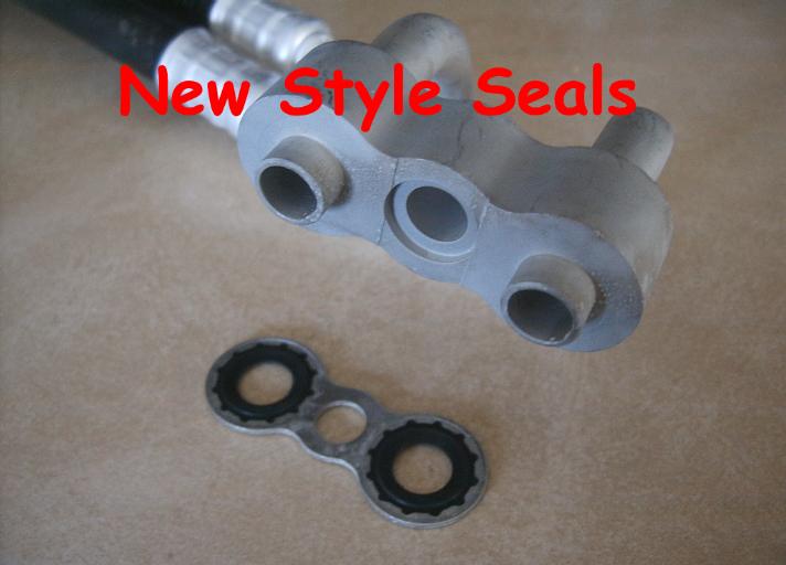

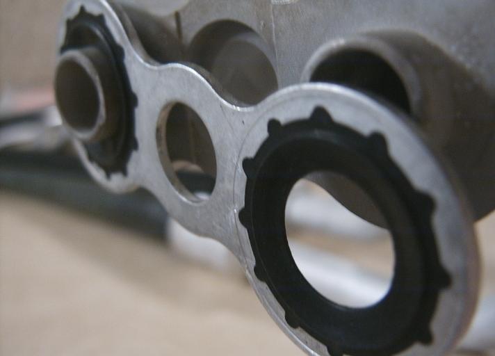

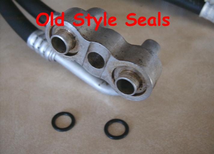

I had to R&R it to scraped off (I mean remove) the old o-rings. It's aluminum, so be careful. Smoothed it up with a sanding block. Clean up area & re-install adaptor.
Installing New Lines:
The new lines should have plastic end caps. Check to be sure the seal is there, them put the end caps back on. Holding one end of the lines near the fire wall, thread the lines down thru where the old lines were. The new lines are more flexible-alot easier to handle. You should be able to wiggle them down to near final position. It's tight, but they will go in there. It's kinda like installing a tailpipe on a 48 Buick. Got to go in there somewhere. If plastic cap falls off, clean it up and try again. Don't tape endcap on. Can't get fingers up there to get the tape off. They should stay on. With lines in place, remove plastic end cap with finger or long needle nose. (I'm assuming you cleaned everything really, really good before you got this far). Align lines & adaptor with one hand, and holding lines up with other hand, slip lines onto block adaptor. Holding lines steady, insert extensions and socket and bolt thru from front. Snug up. Look OK? Tighten. Done with hard part. Beer.
