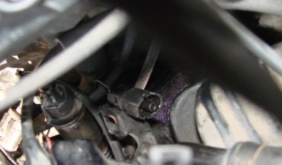

Hi again,
Thanks for your answers so far...
I have taken a couple of pics to clarify. The first shows the connector in detail. The wire is blue and short. The second pic shows more of the location. A bit blurry though.
I still can't find the knock sensor. I have been searching like mad with flashlight, mirrors, standing on my head... Can't find it!
I have also been trying to get a knock reading on the computer by hammering on different locations on the engine where the sensor might be hiding, different rpm on the engine but not a single knock indication.
Am I missing a knock sensor or...?!?
/Kim

Old Sep 9, 2010 | 07:35 AM
Posts: 41,336
Here is a schematic from the newer SCFI engines, but the knock sensor location shows the same for your truck:
As far as it running correctly without the knock sensor... Well, the engine won't know if there is detonation so it won't be able to dial back timing to save itself. But if you aren't having problems with detonation (pinging), then the knock sensor really wouldn't be doing much.
