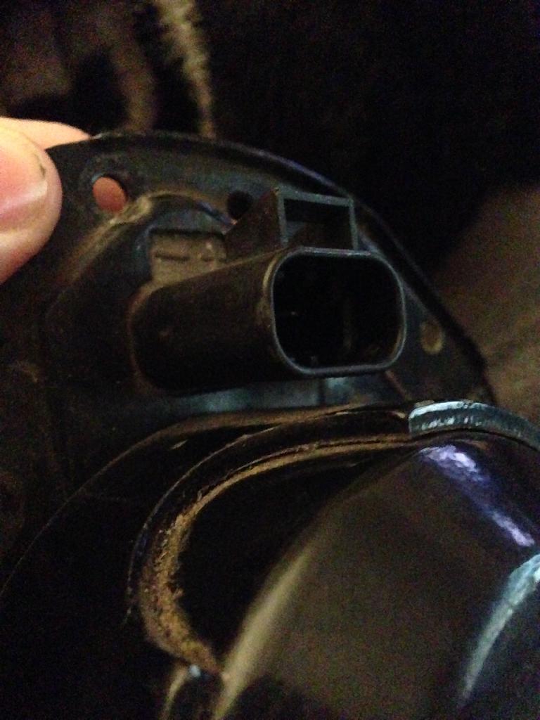

My girlfriend has a 2000 Blazer. The blower motor went out so I took it out and bought a new one from Oreillys. I tried putting it in and discovered it was the wrong connector. I took it back, tried autozone, tried advanced auto parts, and also NAPA with no luck.
The connector is the problem and I cant seem to locate the right motor.
Any chance i could get some help on where to find this part with such little information?
On the motor it says VALEO - 5247715O S 05/24/2000 4A
Here is what it looks like
http://s1153.photobucket.com/user/kshannon199/media/AD679C63-1833-4AE1-8FBA-E5C607628269_zps4l8sfp3w.jpg.html][/URL]

Unless you get an AC Delco motor, the connector is usually a universal style and you need to modify your wiring.

I had one ordered in to Napa and it happened to be the right one although it was way different than all the others. The plug was right but it was a rubber material and fit much more loosely.
Thank you for the reply.
