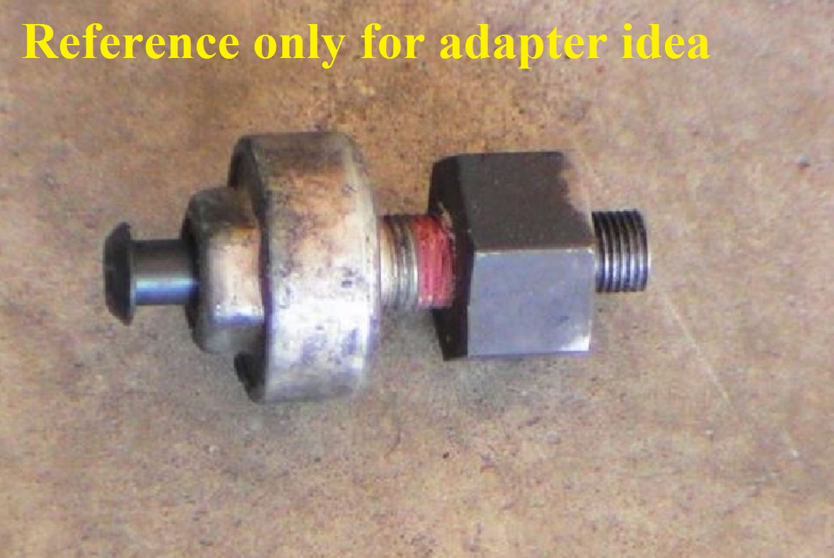

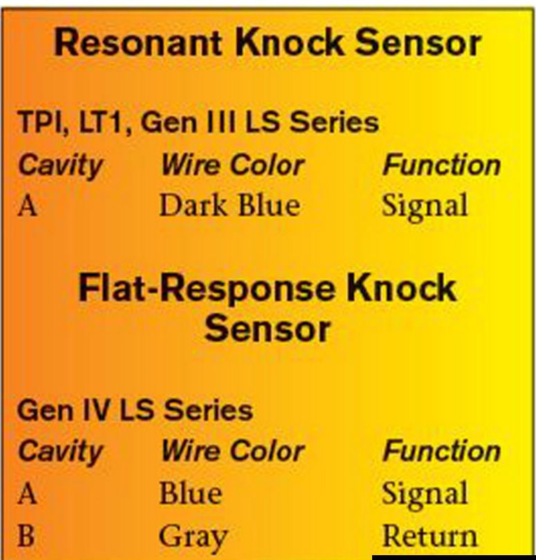

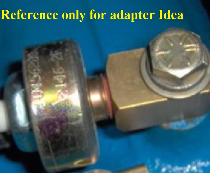

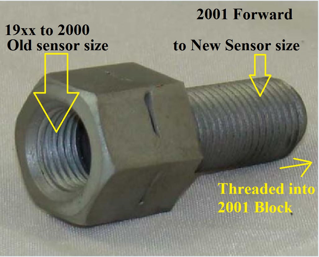

I have read...
1. Can Drill & Tap smaller hole to fit 1 wire larger sensor.
2. Can Use Blue wire and ground Gray one on the sensor.
3. Use a reducer - large female size to male 1/4 and
thread into 2001 block 1/4" small hole.
Pics I have found attached with my notes.

I'd go with option 1. Drill and tap the hole and keep everything 1999. Option 2 is easier if you're sure it will work. Option 3 I wouldn't do because I'm too fussy. The piezoelectric crystal in the knock sensor produces electricity when shaken. Raising it's mounting point even that little bit may create a pendulum effect where it's moving farther than it would in the stock location. I don't know if they are that sensitive, but I know my luck when I try to take the easiest way.

1 wire sensor is 1/4" NPT thread
2 wire sensor is supposed to be 5/16-18 thread
Option 2 will not work - don't do it - check the wiring schematic.
Drill and tap the hole in the 2001 block to 1/4 NPT if you can, and screw in the 1 wire sensor. It doesn't have to seal - just be solid.
